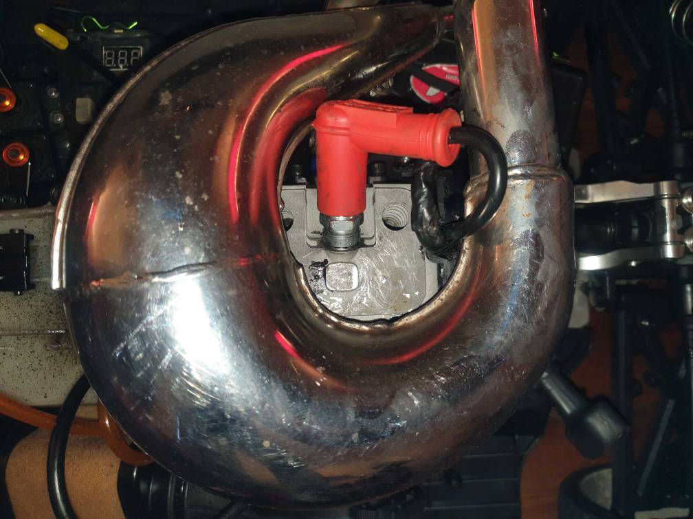

I do think that the faster the air goes thru the better the cooling,
and going across the head would be even better
what are the chance that you may be getting a dead spot in the corner or hot air just moving about in corner
It seems to go through the head then gets directed out right on to the header of the exhaust so far so good I think

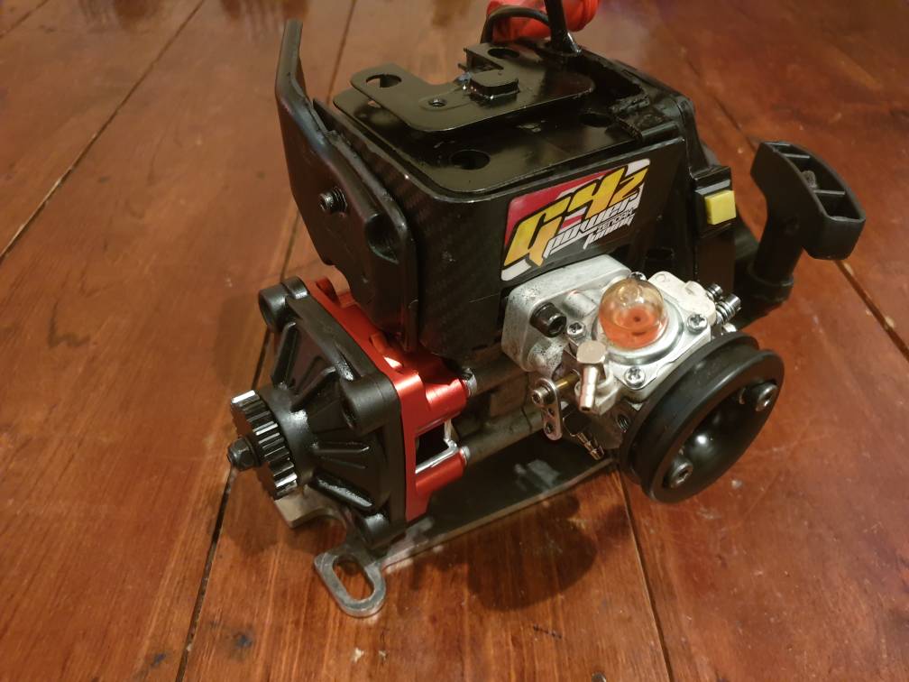

Getting the exhaust welded on the weekend just run half a tank through the engine I can say with the homemade engine cover and open cylinder head airflow is so good that on the exhaust header after 20 minutes running temps are as follows
Cylinder head peaked at 90°
Alloy isolator 45°
Exhaust header 50°
Huge difference from stock
I also increased intake duration by cutting 1.5mm from the intake side of the piston that allowed me to tune leaner and also still get enough fuel when accelerating without bogging down
Teejay112
232
Finished engine here is all the info on it
Rovan 45cc
Increased intake timing took 2mm off piston skirt
Ramped the exhaust side of the piston more angled and more taken off than the esp piston
Internally widened the exhaust port
Homemade alloy engine cover wrapped in carbon fibre
Better cooling by alot
Cut and meshed the pullstar
Port matched exhaust header
Removed the choke from the carb
Not much but enough to almost double the power from the engine in its stock form this engine is a powerful beast now and it revs like a 30.5cc
