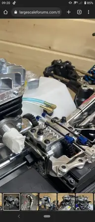

What size brass elbows did you use mate? I'm thinking about getting them and a WALBRO 125-52 bigger clunk filter
