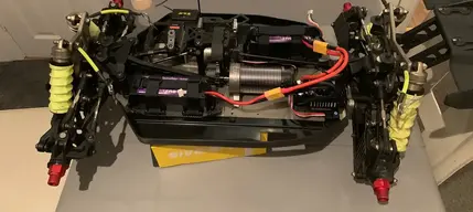

got a few more bits done to nite. So here are some pics of the progress.
first up was the steering servo and receiver tray
Then it was onto the lipo trays. these were a tat tedious as each strap was held in by 2 screws each
then to end things off with the motor install. Sorry I forgot to take a pic at the table lol
all in all the tlr conversion kit has been very good quality But the instructions do miss out a few steps that you have to figure out yourself such as if you want to run mechanical brakes or not so there is alternative hardware for either option.
I went without the mechanical brakes for now just to simplify things down to a minimum.
if anyone has any questions just Ask

as snailtrail said there is not much online about the TLR conversion kit so I am happy share my experience With it.
tonight’s progress has been good. fitted the esc and soldered the xt90‘s on. took some time to pick the best route for the receiver wire.
because I have gone with the grafil g-forza body I can’t mount the esc on the tray that came with the TLR kit as where the Gas engine cut out would be, it goes very low and I don’t want to cut that out. so I have mounted the esc to the chassis.
if I was going to do it again I would have gone for the grafil G-pantox body for the MCD rr5 as this also fits when you don’t need to cut out where the gas engine would go.
all calibrated and working so I went round loctited everything that is metal to metal.
I did find that all x4 hub grub screws had worked loose so did them while I was at it.
now all that is left to do is trim the new body and all being good will take it for a bash this weekend if the weather plays ball.
