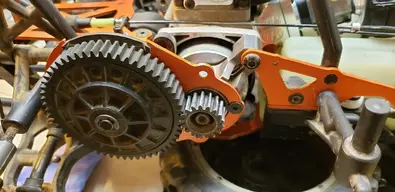

Nope, but you can do what I did. I bought the TR race clutch carrier, bell and pinion on DDM's DOTD a while back and used a flap wheel on my dremel to open up the bearing opening on the stock tranny plate to fit the HD bearing.
You lose out on the transmission plate, but you get the benefits of not needing a spacer on the top right carrier mount and the larger clutch bearing.
Notice the bolt overlapping the oversized bearing race.
It did still end up costing $100, but the whole system was $200, and I didn't have the budget for the whole shebang. And it's still running to this day without an issue.

I would agree, but if he can get the parts on DOTD and do what I did, he'll be 90% of the way there. Then, down the line, when he has the money, he can get the V2 snapper version and already have everything to run open and enclosed versions and save an extra $100 to get some other shiny bits.

If you do go my route, take your time and use a flap wheel if possible. You want to rotate the wheel around the transmission plate to remove material as evenly as possible.
Keep fitting it along the way and adjust where you focus the wheel to make the hole as close to perfectly round as you can get it. Keep an eye on the mounting holes as you work.
Don't be in a hurry here. Take it slow and remove as little material as is possible each time you check the fit. You really want the plate to "click" into place and all the bolt holes to line up when you're done.
I won't lie, it took me a good hour+ to get the job done, but I had a lot more time than I did money that day. And I'm still enjoying the benefit of the effort.
