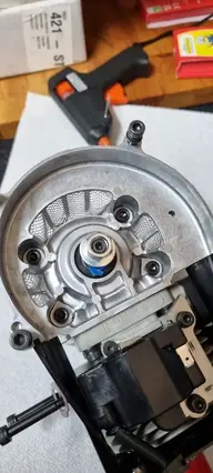

So, in order to get this engine fitted am I right in thinking I have to machine 2mm from the face of the clutch housing and use my old fan cover. What else will I need to modify?
Cheers lads
So, machined the clutch housing this morning, and carried out the mesh mod this afternoon.
Flywheel is off as gonna machine that tomorrow for my easy start, wiring for coil is off as gonna solder the cable in for the kill switch. Will swap the fan cover over when I take one from another engine.
Mesh mod is ISOPON Aluminium mesh, was easy to cut to shape with scissors and easy to form into shape, then hotglued in place. If the hot glue doesn't hold I will go down the epoxy route.
Ps stock filter has been left on as it makes for an easy handle lol, it will be removed upon installation.
