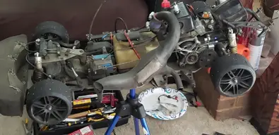

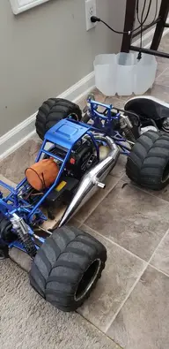

Hey brother, what kind of maintenance do you do after running? Also, just from running your engine can you hear if the tune is right? Can you take a photo of one of your rigs with the shell off (I’d like to see the condition of the rigs we are talking about)
After i run every couple outing i usually use my compressor and blow off and clean off all the dirt and grime and dust. Spray down with simple green and and clean areas that really dirty and blow it all off.
Here a pic of my Rampage under the hood. Shes running like a champ so far. i ordered a couple steering links since i was out bashing one came loose/damaged.
Heres a few pics of my rigs for your viewing pleasure

Soooo... my FG Sportline is not starting again. Didnt take long for something to happen again. Like I said about every 3rd time i take out something comes up. Not sure what it is. Im suspecting maybe its the Coil that i fixed. tried couple diff spark plugs, nothing. Its not sparking at all. Added to that I cant get the freekin engine mount off and stripped one of the screws. Im just gonna tighten the screws nxt time and deal with any loss screws falling out because getting these screws out is a female dog sometimes. SMH.
