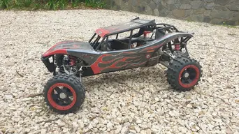

I've got them on my unfinished roller 5ive, sorry probably not the picture you were looking for since there's no body. I have an old set of RC4WD Mickey Thompson MTZ's mounted on them.
Just a bit of warning. Rovan/Kingmotor/Xmaxx and other clone brands made a copy of this wheel, but the offset is not the same. I have original proline and the copies. The copied version has a narrower offset and when you tighten the wheel nut it doesn't seat against the wheels properly leaving a lot of play. The original prolines seat perfectly. It's not a quality issue, just an offset issue. They seem to be only an issue on the 5ive as I have the clones mounted on my HPI Baja and Losi DBXL without issues. The threads on the 5ive's hub nuts don't seem to go deep enough. BTW, better grab the proline desperados while you still can, they were discontinued a long time ago and DDM seems to be the only place that still carries them. Maybe old stock? The clones have held up just as well as the Prolines, major differences being the offset I mentioned, no metal ring around the inner hub for reinforcement and the webbing isn't as aggressive which means overall not as strong. I have yet to break a single one of the clones though.
