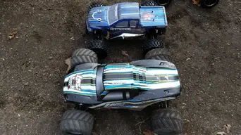

Ya they do look heavier huh. Until I put it next to my Losi MTXL. I just got it a few weeks ago. Have yet to weigh it.20181104_135601.jpg

I use a bathroom scale. I weigh myself and note it, then hold the RC and step back on and subtract the difference. I thought the mtxl would be heavier than it is, but picking it up it really isn't.

The stance and big tires make them look heavy. I don't think they really go more then a pound or so heavier over a dbxl.
