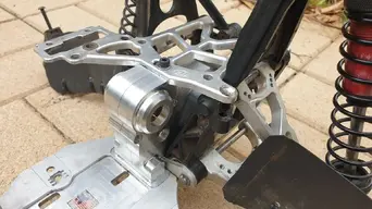

I have the RCMax V2 case and it fit perfectly, I just don't understand what the hell that threaded hole is for at the top.
There's a pocket that was machined into the case which the threaded hole leads to, effectively a water trap.
I put a greased screw in there just to mitigate any water ingress, don't fancy that pocket filling and slowly seeping in and onto the gears.
Supposed to have a cap screw in there? when ill take a picTo use your photo, it would be roughly here:
The notch at the top has a threaded hole which leads to nothing but that machined out pocket.
I'd show you mine however it's already installed, not to mention my cat has taken permanent residence on my lap.
That's what I assumed it was for, though I'd rather that pocket not exist, or just not drill/thread all the way through to the pocket.Supposed to have a cap screw in there? when ill take a picView attachment 69471

So it fits? but dose not drop in like a TR case ? wedged in there?
