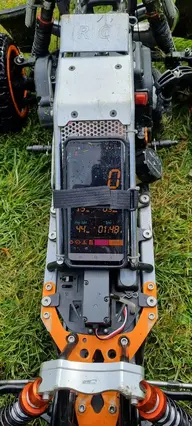

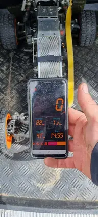

So, been out again this morning to try out the different gearing and test the tune again, also to test steering as changed the steering servo last night.
So, with the 18/56 I get 44mph.
With the 17/57 I get 41mph.
Looks like I can also go 18/56 but gonna have a good look at the mesh first.
But for now gonna stick with the 18/56.20210506_111615.webp20210506_113904.webp

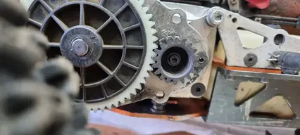

I got 44 on 18/56, but took some pics of the mesh on both 18/56 and 18/57.
I've left it as 18/57 for the next run.

yeh its weird that hpi do actually list 18/57 as an option for gearing in the destruction book kev,
everything else says must add up to 74 teeth for both gears,
then say it'll be fine on either 17/57 or 18/57,
and nope i'm wrong, hpi list 16/57 as an option kev
17/57 is normal mesh and 16/57 is loose mesh,
so 18/57 may be too tight and feck the spur :)

The 18/57 didn't feel tight at all, had the smallest amount of movement between them, did about 5 full rotations of the spur to check for any tight spots.
I'll give it a bash, the spurs are only £10 if I chew it up.

Right spents, been out testing gear setups this morning. My engine can't pull 18/57 to max rpm, or the grass was just too wet. Would only do 41 with 18/57 on, banged the 56 tooth on and straight back up to 44mph.
