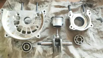

Wow yeah that's not good. Not sure what kind of damage it woulda caused but good thing you caught it. Is the crank fekd? Or bearings?K I have some updates?? unfortunately it's not all good new?? my motor started making a poop noise few weeks back?? did some trouble shooting on it
Re gapped the coil changed the starter?
Stripped the motor down and found horizontal play on the crank??? not throughing a sausage down a corridor ?? but more than it should be.....enough to hear a click. .........So I have stripped the motor right down and I'll rebuild the bottom halfView attachment 54732View attachment 54733
Made a short vid of the noise???
Throwing a hotdog down a hallway you mean ?not throughing a sausage down a corridor ??
Even if it's the crank, think just $50 ?? vs looks 300 for the 70cc crank ?? wonder what caused that ?I think it's the bearings..? hope it's just that ?
Might need to take extensive pics, an we might need Sean in here. Hell have a idea I'm sure ?Feked if I know......
Yikes! That sucks mate. Hopefully the cylinder didn't take too much of a beating.
