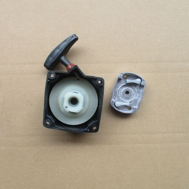

What do you man? You saying the paw on the starter is wrong? It's slightly different in shape but same sizeZ ,that pull start does not go with the paw on the engine ,the center teeth on the pull start is way too big ,an
is not the right one ,it is suppose to be smaller in diameter to fit inside the paw!

The teeth on the start is suppose to stay inside the paw ,that doesn't look like it fits inside that paw ,I will go look at my
stuff an see if I have one to show as an example!....
Here is a pic that I found on line of one ,you can see were the paw fits over on the gear that catches or
were the pully teeth go inside the paw ,that's the way it should be ,your paw doesn't look like it fits your
pull start gear ,it is too small!
