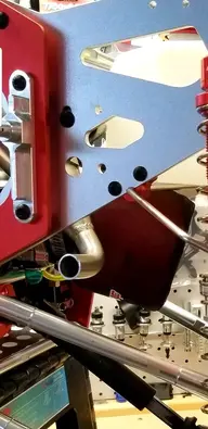

Spider not angled. Truly concerned about fitment. I only run Bel Ray filter oil and cleaner currently. Really good stuff. I currently have a Bortolone V2 stack...would I need an adapter?
Ehhhhh... looks like you might have room for the spider... but you have the truck in hand sooo... you need at least 3 inches up and down and 1.75 in between
I bet you got room 🤔, but like I said, u got the truck
