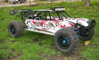

Oops! I forgot the diff build that both of the Revos have! Sorry my bad. Here you go:
The first picture shows the spots that I had to grind down to get the center drace to fit. These are the E-Revo gears!
The one thing I like about wings on rc is it's a handle when you need to carry it. So when I installed the wing on this build that wasn't possible. So I changed it so that it not only looks better but it's easy to grab on to. I used 1/8 buggy front arms to mount as bracket for the wing to mount to.
RevoDesertBuggyXL014_zps24ad52de.webpRevoDesertBuggyXL013_zps464fa9ae.webpRevoDesertBuggyXL019_zps36cf07db.webpRevoDesertBuggyXL016_zps34ba961e.webp

RevodesertBuggyXL004_zps352afda5.webpRevodesertBuggyXL003_zps377f4026.webpRevodesertBuggyXL001_zps383457e2.webp
I will get it installed to the cage so that it lifts when I pull the 2 body pins. I will finish the cage that I cut out and also build a cool air ram also.
With the added scale motor I'm hoping I can still be under 19 pounds. I order some one piece lipo trays. I think that I'm not adding a carbon pan to this build to keep weight down. If it gets to messy inside I add some light weight plastic.
Well my Goal was to do this build loaded a19 pounds That is 10 pounds lighter than the orignal Losi Desert Buggy XL! I made it It is just under with the 1/5 bead locks and a pair of 2s 9400 lipos. I'm stoked!
