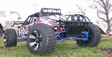

This is on my other build that uses a Yeti XL body. So the wheelbase is only 18.5''. But this shows how I'm setting up the 2 speed trans for both Desert Buggies.
The front lite buckets that are from the Losi 5ive is now a functioning set of 10mm lites with flashlight lens to get the look I wanted. I will be using resistors to keep the voltage as it should using a 2 cell liopo battery.
