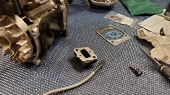

I took the head off and she looks good. Ring moves free and no gouges in the cylinder or piston.

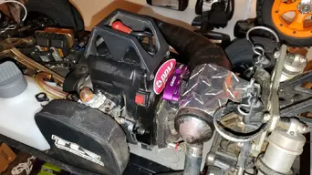

I really do appreciate all the comments and help fellas. Keep the suggestions coming. With you guys help I'm sure I'll figure it out.?? Now I have to wait for a new head gasket before I can do anymore testing tho. Guess I'll be taking the Vekta or Rovan for a spin.

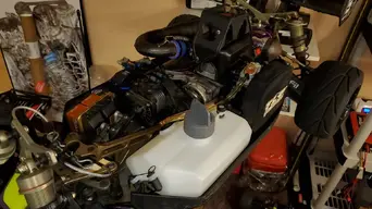

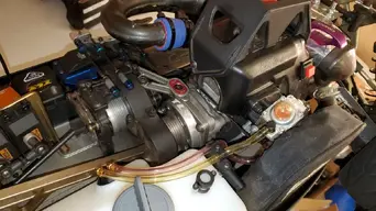

A little update. Got her all back together. New head gasket. New intake gasket. New tank. New tank filter. New lines. New vent and cap. New exhaust gasket and coupler. Coil regapped. Carb and intake torqued down to 31inlbs. Head torqued to 61inlbs. Gonna get her out tomorrow.
