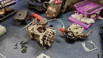

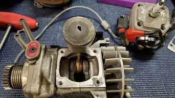

I'm not sure if that would cause it. looks like detonation or a running wayy too lean.Aight...got her all buttoned up this past Friday, with all the new parts and took her for a run on the street with no problems and she ran great for about 25 minutes(because I only filled up the tank 1/2 way).
Fast forward to today I take her out to the field to test her again and get 5 minutes of run in and she shuts down. I tried to start her up and there was no compression on the motor so i knew something was wrong. ?I noticed the plug was loose if that could have caused anything.
Did you see the hole in his piston??loose plug=no compression
ahh yes I did.....thought it bhapped after the holy incident.......cutting out/loose plug
Yeah but I don't think a loose plug would cause that. Maybe. Wrong thoahh yes I did.....thought it bhapped after the holy incident.......cutting out/loose plug
I ment lack of compression=loose plugYeah but I don't think a loose plug would cause that. Maybe. Wrong tho
?Was that caused by too much heat isolated in that one area ,it looks like it maybe drawing in cold air on a hot piston!.....
