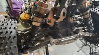

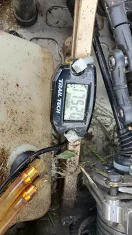

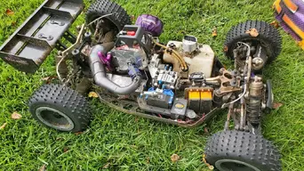

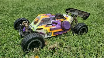

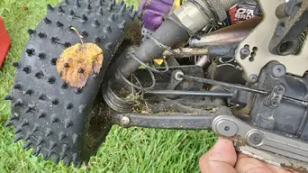

I had a great run today until I started to jump and a tree reached out and said ๐Ÿ‘‹ ๐Ÿคฃ Rear shock end pulled out. No biggie. I just ordered some more from ddm. The rpms on this sig series w the olimat and 21T pinion is a beast๐Ÿ‘Œ๐Ÿฝ. She started right up and ran great. Didn't even touch the needles. Temps stayed at 130deg F. Video coming soon๐Ÿ˜Ž

Glad I didn't buy any...I saw your post yesterday said damn those look nice. And though to myself it's not worth a single item order. I hate doing that for shipping reasons
The rear ones have lasted. It's just the fronts that both cracked. Be warned tho, they are not true carbon fiber, just plastic with a CF wrap on it.
