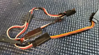

Damn ur vekta is like my Baja , problems every run ??? jkTook ole girl out today and got a good 10min run then the steering started to get bad. Pulled her over to try and see what was going on and couldn't find anything but it would only turn about an inch in wither direction. So figured I'd put her up. Got home and started to investigate. The forward most servo gears were gone and I found some burnt wiring in the batt box. I think the wires melted together causing the 1 servo to over extend then stripped the gears. I hate the vekta batt box. I think I'm gonna come up with a solution. I removed the damaged servo and wiring. I now have it on 1 steering servo so I can get her back out there. View attachment 60073View attachment 60074

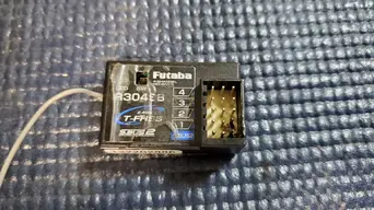

O its fekd. I have an extra sanwa that I'm going to use. Its smaller than the futaba so thats a plus.It didn't mess the receiver up ? It looks a little melted ?
In my cart at ddm, along with a new servo?? Never had any issues with the dual servo Y-harness on my L5B tho?You need to get a bypass harness for those duel servo set ups, or at least micro fuse them. The harness would have saved your reciever, as it would have only been sending the signal. Not power and ground. I've feked a few recievers in my rock crawler before. drawing too much amperage through the reciever.
All that current in the Y spliter??Never had any issues with the dual servo Y-harness on my L5B tho?
