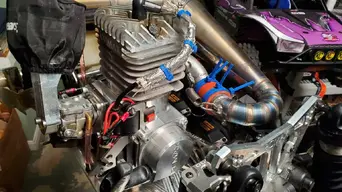

Gonna have to clamp it for sure
Yeah, I think since I have 2 of each type I'm gonna use the regular red one 1st with some hi temp cable ties I just got then if I still have a problem I may try the black one.
Can you put some ptfe tape on the header before mating the two then the black coupler over๐Ÿคท๐Ÿปโ€โ™‚๏ธ
That should seal it up.
๐Ÿค”I wouldn't think the thread sealant tape would hold up with the manifold heat. It wouldn't melt?
crucialRC
Sir Lancelot ๐Ÿ›ก
Build Thread Contributor
3,013
Maryland, USA
It sort of melts into a seal, it certainly doesn't melt and run all over the place. ๐Ÿ‘๐Ÿป
Cool, I'm gonna give it a try next if this fails. All back together now and charged up for the next run. Pull start fixed, dual turnbuckle ends swapped out for some longer ones and coupler fitted with hi temp cable ties.
