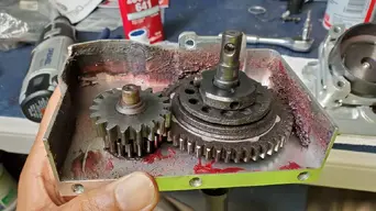

Not on the ddm site. I haven't check krakenrc.com site yet but they usually don't have much in stockis that the T90 transmission ? carrier not sell loose?

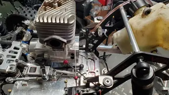

Rev thread nut was loose.Damn that sucks and do you have any idea why this might have happened?
Really think it shouldn't be too bad. I ordered the bearings and they are coming from KY so shouldn't take long. I think im just gonna knock the burr off the carrier and put the new bearing in. Just a PITA to pull the t90 trans??Man that sucks, hope you can get it fixed up.

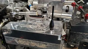

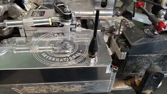

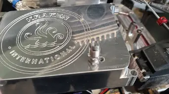

Should be easy for you bro. Let me know if you need any dimensions or anything??@crucialRC nice!! i like that antenna holder. i gotta make something like that to include with the box
Will do my friend! Thank you! ????Should be easy for you bro. Let me know if you need any dimensions or anything??

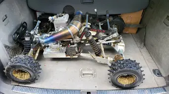

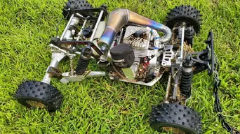

Should Polish y pipe like me, look even better ? good work ?All finished up with putting her back together??
New bearings came in today

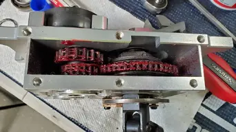

Used retaining compound to keep the bearing where its supposed to be.
New and old
Used a large socket to tap the bearing in
View attachment 62704View attachment 62705View attachment 62706

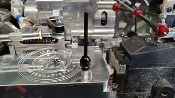

Reverse thread nut cleaned with carb cleaner and loctited real good. I don't see it backing off again?? I only used 1 free spacer instead of the 2 that is supplied by Kraken to line the gears up. I had used 2 without even checking the 1st time which caused a slight misalignment of the gears.

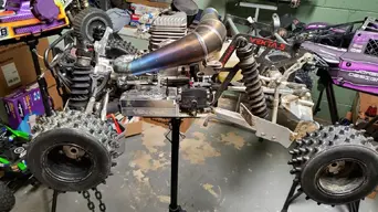

That pipe is looking nice and blued. Letting the loctite setup now and trying to make time to get her out befor hurricane Laura remnants make it thru here.
