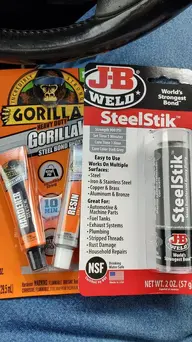

I'm not sure either will work tbh certainly not for any considerable length of time anyway, if you are having a go though drill some small holes at the end of the cracks to stop them running ??Guy at the ricer spot said I might as well buy a new one. Said the filler rod is $100 by itself. Said I was looking at $400 or so? Guess we are going the epoxy route until i can find a new one. Not sure which one yet tho. Any suggestions?View attachment 62832
Found these at the autoparts store
Are you in PA.? I used this as a search in Google "custom ti welding pa." and there was a place in Harrisburg you could try. You need to find a shop that already has the equipment . I wouldn't give up on that pipe so easy. The guy was saying 400 to scare you off.Guy at the ricer spot said I might as well buy a new one. Said the filler rod is $100 by itself. Said I was looking at $400 or so? Guess we are going the epoxy route until i can find a new one. Not sure which one yet tho. Any suggestions?View attachment 62832

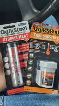

Yup, I used 80wt I believe. Glad to help others. Learn from my mistakes?This is a great thread. You’ve done a over the top amount of great work that’s shown so much info for other Kraken builders. I sure hope you can get the pipe fixed without having to buy a new one. JB Weld is an excellent option, but for heat over 200F I’m not sure how it will handle. I am curious about one thing and that is what you had to do with your shocks adding all that weight of the RCMax. Did you swap out the 8 hole pistons for the 4 hole or change oil weight? Thanks for all the great info.

Epoxy is great until there is heat ? involved ??? id go with a exhaust wrap with gum stuff........it used to patch steel exhaust with holes? not sure what they called over there. ? I use to by "gum gum wrap"?? goes on wet drys with heat and gets hard ?? thats if you going to make a plan until a new pipe comes along
