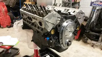

Too bad your not closer there's a machine shop near me that I use all the time when I build my engines. Richie Machine, good people. These are pics of my Chevy 461 and 406. They did all my machine work and I put them together. They are like mad scientists with their micrometers and calipers.?20150921_161525.webp20141020_180108.webp20141020_182920.webp20150919_155008.webp
