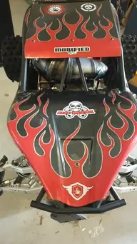

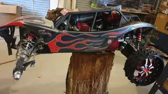

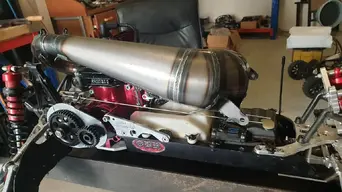

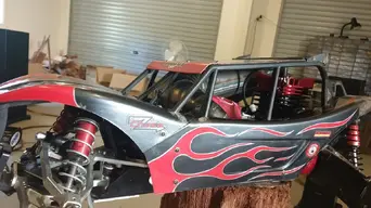

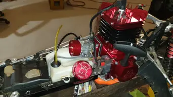

Managed to squeeze a couple hours in after work??20210223_204126.jpg20210223_204145.jpgradio tray throttle linkage ?? tank and the killer bee ?? gear plate and brake mount ? still need to trim down the pinion and the only other thing so far im not happy with is ......rekon the linkage will rub on the crankcase need to tweek it a little more??
The rubber mounts are under the stainless L bracket ?? and unfortunately the sx5 cage mounts bolt up in the same spot? and if I flip the left one the cage won't mount up ?‍♂️ so........ its gonna have to be like it is?‍♂️ what should of happened us SAMBA who made the pipe should have welded the left to the right and right to left?‍♂️
