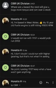

I just asked the OBR UK division how willing the full mod G340 Reed V2 is to rev on 17/57 gearing and was not really given an answer, despite asking - more than once.
The responses were from a nameless person who merely pointed out that "I didn't want to run 17/57 gearing".
Thanks for pointing out what I want.
Then I was told that I need to stick with what I've got - my 15 year old Fuelie engine. Which as it stands, still goes rather well - 19300 RPMs and 49mph on 17/57 - but that's hardly the point.
Not once did I get an answer to the question I asked - ie - how willing is this engine to rev.
What I got was a gear ratio 'I'd prob run' from out of a hat, without any knowledge of where I was running, or on what surface, or what altitude! 😝
It seems a very strange way to do business.

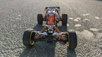

It's a shame, because I was thinking of bolting one into this:
But apparently, they 'know' what I need.

I may not be doing a full mod OBR G340 Reed V2 any favours running 17/57, but it's courteous to answer questions adequately prior to making a £460 sale. Not just tell your customers what to do. 👍
My question was - what sort of RPMs would this engine achieve on that gearing. My question wasn't 'what gearing do you recommend'. I'll arrive at that myself once I know the damn specs - and RPMs is one of them. They're quite happy to tout 9.4hp, but then get all cloak and dagger about RPMs. 🤣
Your answer was helpful - it quantified 'about the same' but 'get there quicker'.
This is an answer that should have been afforded - at the very least - by OBR UK, but I was told 'keep what you have'. 💩
