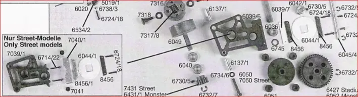

So your problem is no drive. Does this mean when you rev the engine the engine spins up but the gears on the gear plate are static? If so the clutch is not engaging or the belt is trapped jamming up the gear train
If the engine spins up and the gears on the gear plate turn but the rear differential is not spinning up then the layshaft gear has come loose on the shaft (common problem).
Btw, the 4wd belt drive is driven from the rear diff. If you have drive to the rear diff but no output to the rear wheels the front wheels will still be driven by the belt because the rear diff will be spinning up to create the drive, if that makes sense, so your problem should be easy to find.
