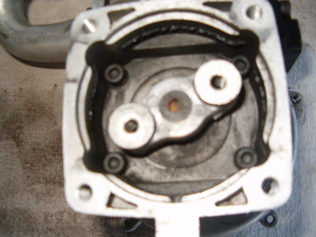

KM Baja.

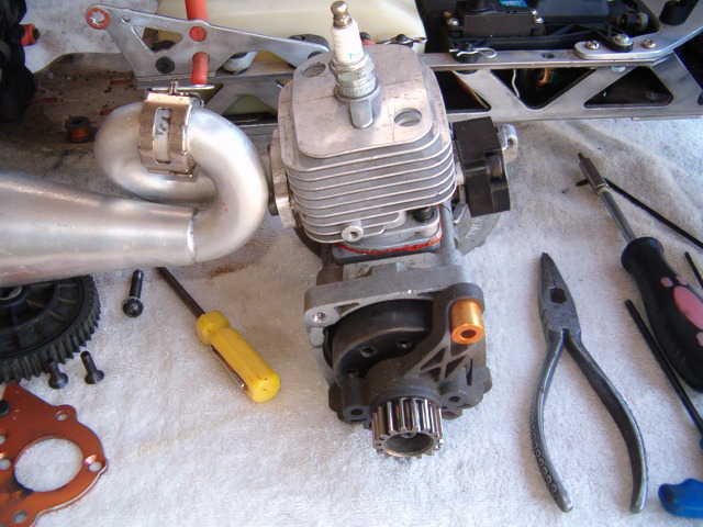

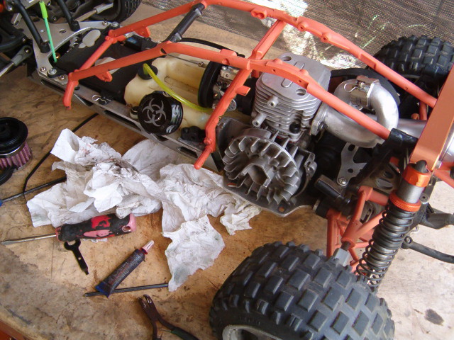

Holly silicone!
LOL....I know ,it looks bad ,but really not ,there is none inside the engine ,that was a thin film ,it
is weird that it bunched up on the edge because I always set the parts on an not tighten them down
until after the stuff cures!
The transfer ports are already factory opened ,so I don't know what can be done ,other than exhaust port
shaved ,not sure!
I think that I might just put it back together an put a new spark plug in it for now an look for a better engine!...:cool:
It's an open transfer cylinder. There is more to be had. Out of it. Depending on what vids you've been watching you'll see mostly closed transfers. If they are saw porting vids, no one really want open transfers. Less performance out of the same displacement.

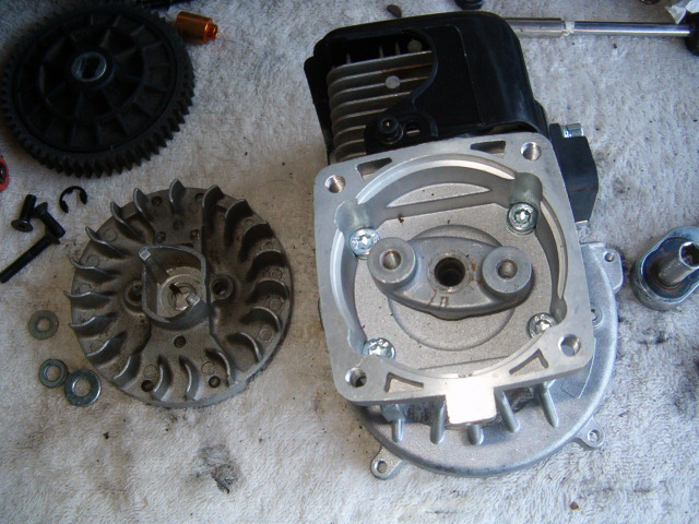

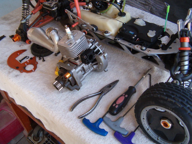

I cant get the fekin screw out of the crank that holds the shoe mount ,an actually ,I don't want to reuse it ,I don't need the
mount as the Shindaiwa one works from the hedger but the bolt for that one is fekin reverse ,Im fekin screwed until I find
one that fits ,I have a ton of them in my shed ,I don't want to go in there!....FEK.....
Ok ,I found a screw with out entering!......:whistle:
But is there a specific position on the mount for balance that people prefer?......:unsure:

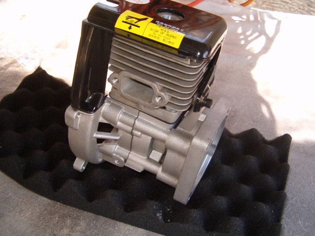

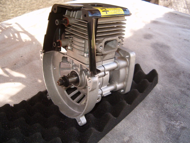

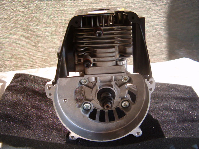

This is it sitting before I tighten it down.
Here is the old.
