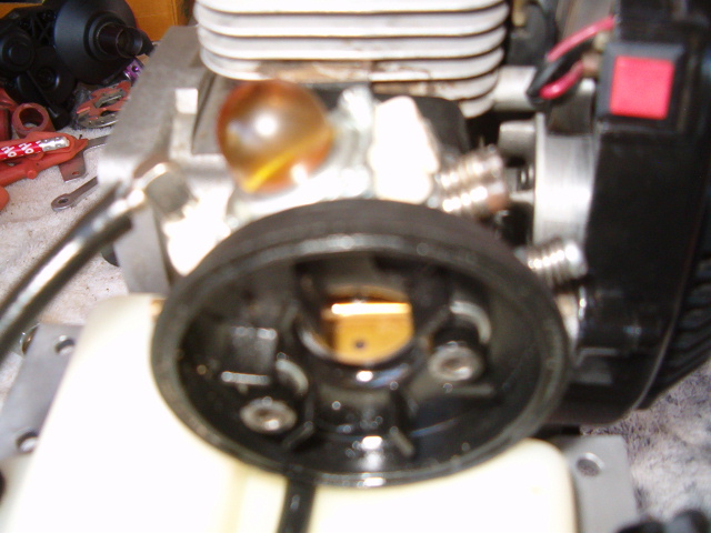

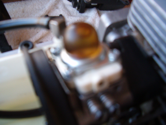

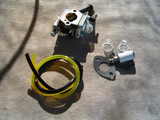

The carb needs kitted ,it will flood as it sits ,but once I open the needles up after I start it ,then it stays running ,I
remember now a few years ago ,that it was happening ,that why I quit running it ,that is why it doesn't return back
to idle ,an caused me to wreck ,that is why I was playing with the sets ,wasnt tuning!
Here is another vid. ,it is flooding ,an it is the carb. the tank is venting like it should ,so there is no built up pressure in
the tank forcing fuel!
I am quite happy that it will still run with the way the carb is ,at least I know what the issue is an it will stay running ,
but will not attempt to drive it until I get another new carb or fix this one!

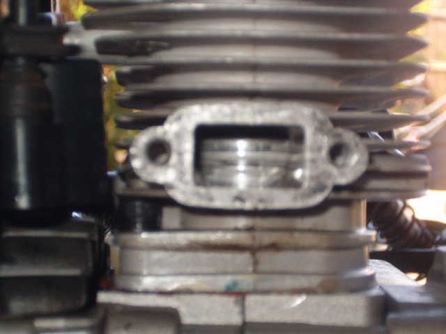

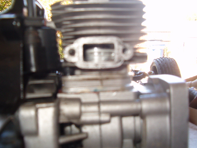

with the twin ring piston, Did you check to make sure that you did not have any ring end gaps that were not supported by full cylinder through full stroke.
The engine ran fine with the dual ring before the carb dried up over the 2 years of sitting!

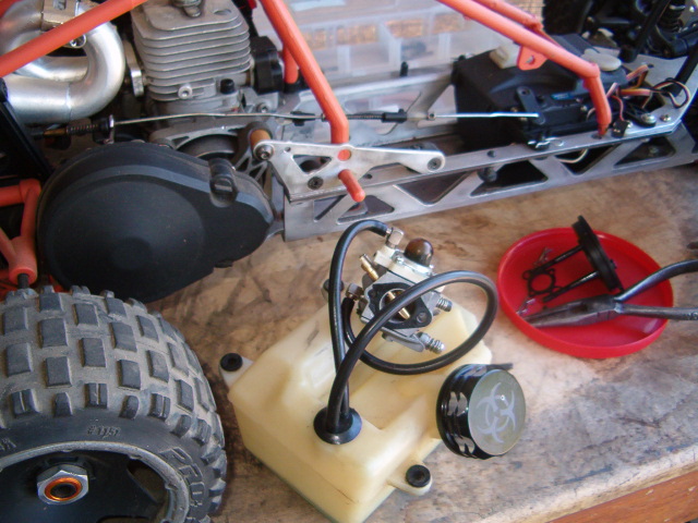

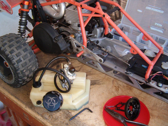

Time to pull it out an take the old carb & tank out ,my new carb should be here this afternoon ,tracking shows
that it is at my post office ,an it is out for delivery!....:cool:
Will be installing the new fuel lines & filter as well!
What carb you going with?
It is basicly the same thing what is on it now ,as I don't want to sink a lot of money into this right now ,later
I might upgrade the whole engine!
That being said ,an I don't know what it actually is ,I will just call it the Junk brand!...:p
It was cheap ,so if something else fails ,it wont be a loss!...:cool:

I hear ya but you can swap carb over to the new engine.
