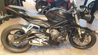

So any plans for the future with it? After you get your other license u gonna get another her bike?
Man that bike is sexy! Those integrated tail lights will be sweet What's your thoughts on a steering dampner? I've been watching these tank slapper vids and curious what you thought about the dampners?
Edit: Speaking in general about the tank slapper vids, not directed towards the Triumph just a general question.
