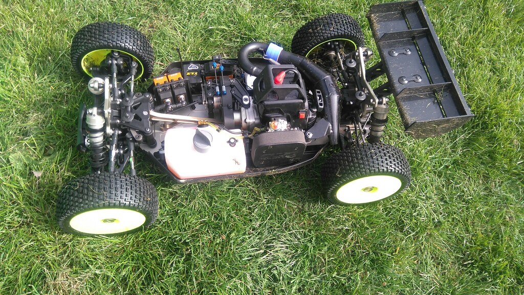

Right bit of an update with my build thread, Iv ran it for half a tank today so far its absolutely amazing! Turns very quickly and its a lot faster than i thought it would be, i was expecting the g290 to feel under powered but its the total opposite.

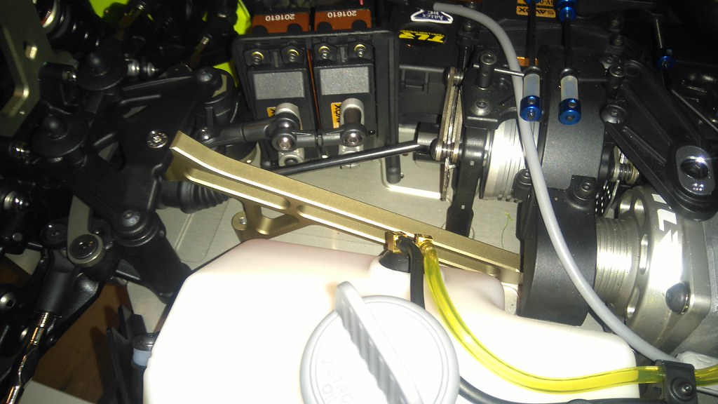

Also it got its first upgrade installed this evening.

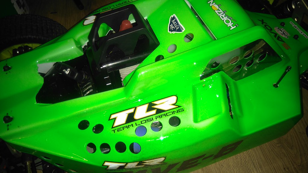

I noticed my throttle servo was very hot towards the end of my run, and i only ran half a tank. Iv only got a couple of small holes drilled in the body at the minute so il be drilling a few more before i take it out tomorrow. Overall im very happy with it.
@tanveer on the petrol tank swop fule lines there's a letters on the petrol tank outlet F and R return goes to the side of the carb with the prime bubble on . Feed goes on the underside of the carb
I swapped the fuel lines over this mprning before taking it for a run bud. So now the black hose goes to flow and the clear one is return. Is that the correct way?

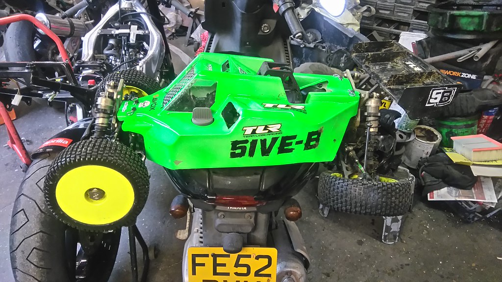

Got to spend a couple of hours with the 5ive b this morning, got two tanks through it but i noticed it was getting extremely hot under the body shell and the throttle servo was almost too hot to touch. I let it cool down for half an hour and ran it again for a while without the body shell and it stayed completely cool. Sat down tonight and cut a part of the body shell away and cut a few more holes, some more testing will be done tomorrow.

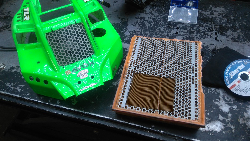

Have been out today running the 5ive b again, it runs much cooler with the front window cut out and the extra side cut outs. But the inside was getting very dirty very quickly, so i used an old air filter i had laying around in the garage and meshed up the front window....Also lost a screw for the rear turnbuckle, checked the manual and i completely forgot to put the m5 nyloc on the front of it so its just popped off. I thought i had broken something at first.
