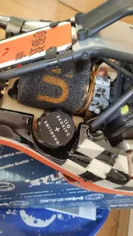

Hi guys. I hlave one question.can the front window reduce performance due to poor airflow into the air filter? I use velocity stack+ uber RC filter.

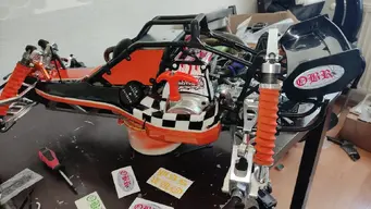

First SS start after 15 min on iddle,but the idle screw does not respond.where is the problem? trottle linkage? i don't see a mistake there.after driving, idling is high, but then it lowers and the engine shuts off. idle screw is screwed in as far as it will go. does not respond to gas settings or the radio.but I am very satisfied with the engine's reaction to the gas . it will be an animal ))
it will probably be a carburetor. I left the settings as they sent me . It is 1,1/8 L and 1,1/2 H right? wt 1242 carb
