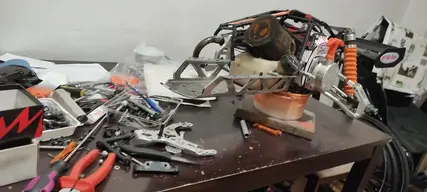

I recorded my first short bash and "crash " :-( I didn't even have time to set the carb. because my chassis is broken after the " flip " (original hpi) so now my head is in mourning and I am still immobile. engine goes well I still i ran on base carb settings. so i still don't know how the engine will go at full power but feel like it will be powerful. now with a 19/55 gear ratio going easily on the wheelie and my baja is heavy weight . But I didn't even go full throttle due to lack of place .I choose the wrong place to bash and thus punish myself and Baja : D .. now I'm waiting for a new exhaust from OBR and a new chassis and other damaged things. I did not expect such a devastating crash...

Broke my chassis in same place. Looks like you don't have a stiffener plate on bottom. Definitely get one for your new chassis.
yes i know i didn't have it there. it was a mistake and I'll mount it there. do you think that with a skid plate, a rovan chassis will suffice? I still have the possibility of purchase the original hpi chassis for 130 euros from us in Slovakia. in one shop they have one in stock. or rather IRC? or it doesn't matter ?
I don't know what to recommend. I bought a scorpion chassis but the engine mount holes don't line up perfect. Not sure if it's the chassis or rear engine mount plate? So I don't know what to recommend you.
i like enclosed chassis. but when falls inside chassis the screw or washer it is a problem to pull it out :D . I could order something they offer in shops in GB or USA. but I want it fast . in the EU I can get to purchase only Rovan or Hpi chassis .who knows the difference in quality when I easily broke the hpi)).but from what I've seen in the rcmz community on facebook, rovan is probably breaking like bread: D . if the skid plate really prevents that break , doesn't it matter? or can it break anyway? what do you think)) maybe I should rather wait and buy something better quality . Hpi lasted me 3 years without a skid plate and I hit a football gate and just only bent the chassis also everything else: D
