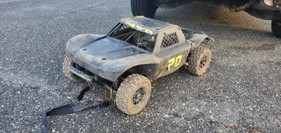

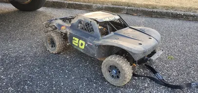

It does pretty damn good with grip on the road. I was hitting that corner at full speed and just letting off the gas and getting back on it half way through without spinning out Earlier before he started recording.
Awesome build Ryan. My 2 cents for what it’s worth I would try to make the shocks a little stiffer and set the droop screw down more. The weight transfer under acceleration will really kill performance on the track. I also recommend not worrying so much about ride height and focus more on keeping the an arms level and then tuning from there.
@misterleon thanks and I appreciate the feedback, the rear arms are pretty much level so ill work in adjusting the fronts. I do see what you mean as when I hit the gas the first bit of movement really is the the weight transfer to the rear then it takes off. I think I have a good balance of the diffs with 60-500-80 :unsure:
I'm telling you Ryan, get a set of limiting straps. I'm not using mine atm so I'd be more than happy to send um your way to try before you buy. That weight transfer is dumbed down a lot, the straps don't let the nose come up. As much at least.
Edit:
Plus they helped keep the inside tire down in corners. Before I got them I would be 3 wheeling into turns. Kills the tires.
