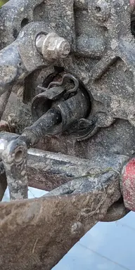

And do you dbxl owners...when you lose pins out of the axles body pins will NOT get you out of a jamb. Centrifugal force I supposeView attachment 64439
Does a bear ? in the woods? ?. Normally not as bad as hes had it lately, but yes they do tend to fling pins out. Tbh since I've switched over to flm shafts it hasn't been such an issue.... ymmv.Seems like the dbxl has a bad habit of flinging pins ?
You can make the pins out of partially threaded Allen screws. I think those pins are 5mm? Cut the Allen head off and the threaded part with a dremel. Then heat it to a cherry red with a torch and dip it in motor oil or waterJust to report back...the coupler held for a good (benefit of doubt) 20 minutes. True losi fashion.
