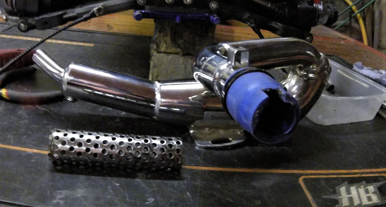

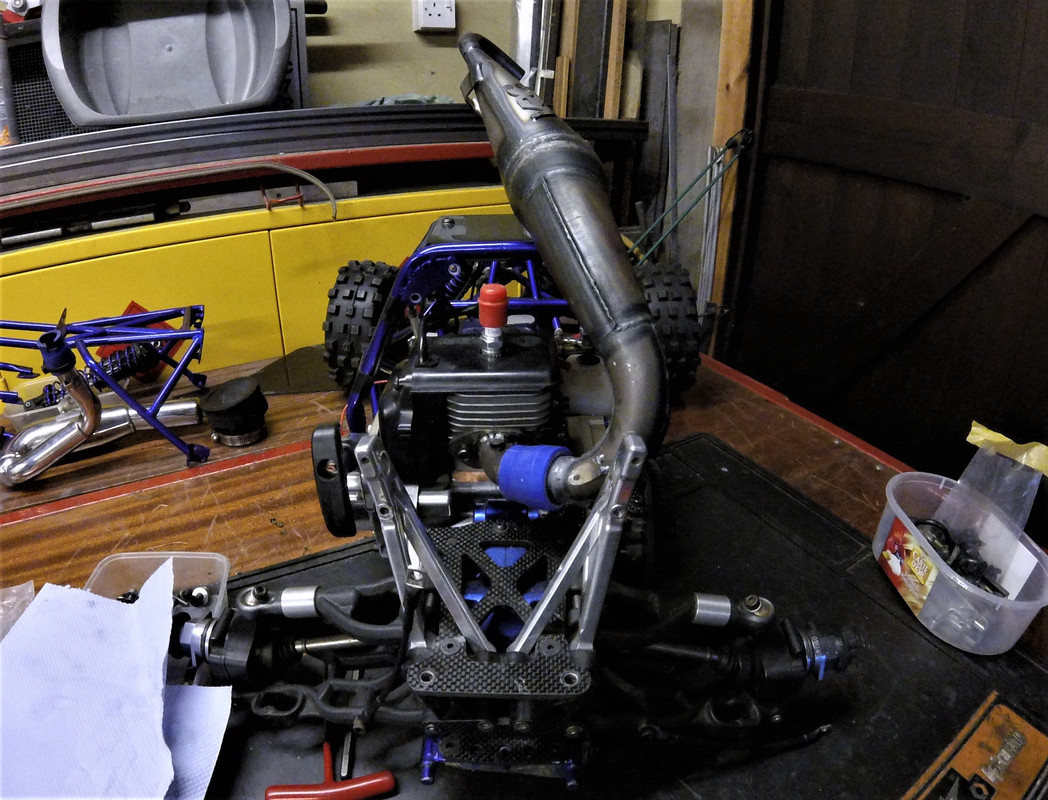

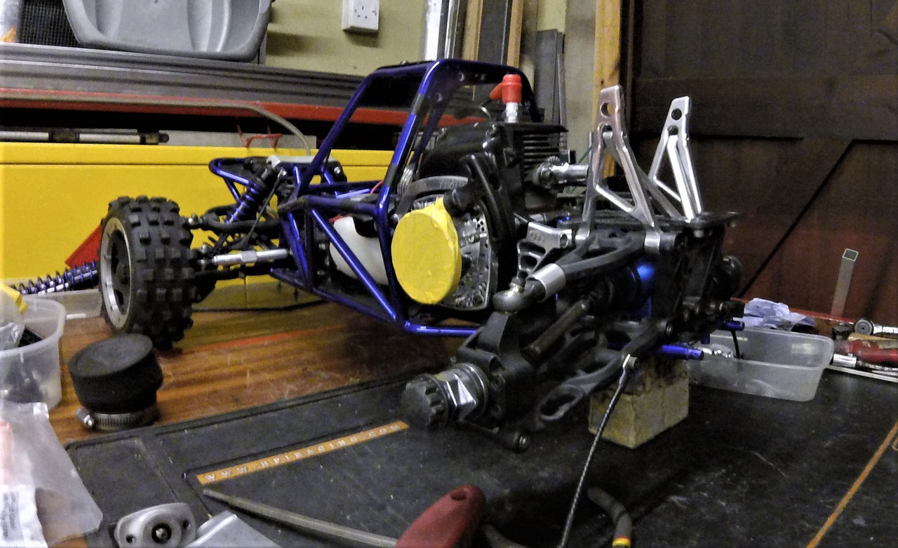

but decided to have a look and see if i could get a different pipe to fit the rail,
vrc pro is a definite no no ,

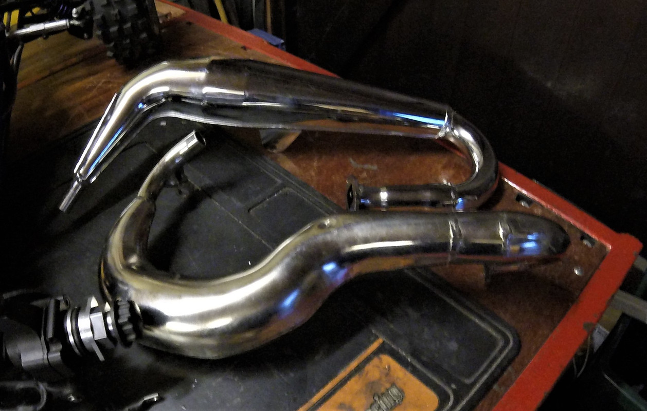

then had a look at what other pipes i had ,
right side jetpro off the twin is a no no, so is the fg ddm dominator, although the fg pipe was close to actually fitting,

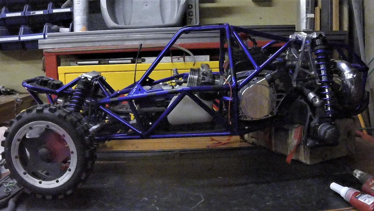

looks like side pipes are out cos of the shape and size of the shorty rail frame,
i thought about using the fast pipe off the delboy rail and fitting the vrc on that car instead,
but the fast pipe is a tad too high for the rear section of the rail to fit back on,
so looks like i'm stuck with the v2 silenced dom,

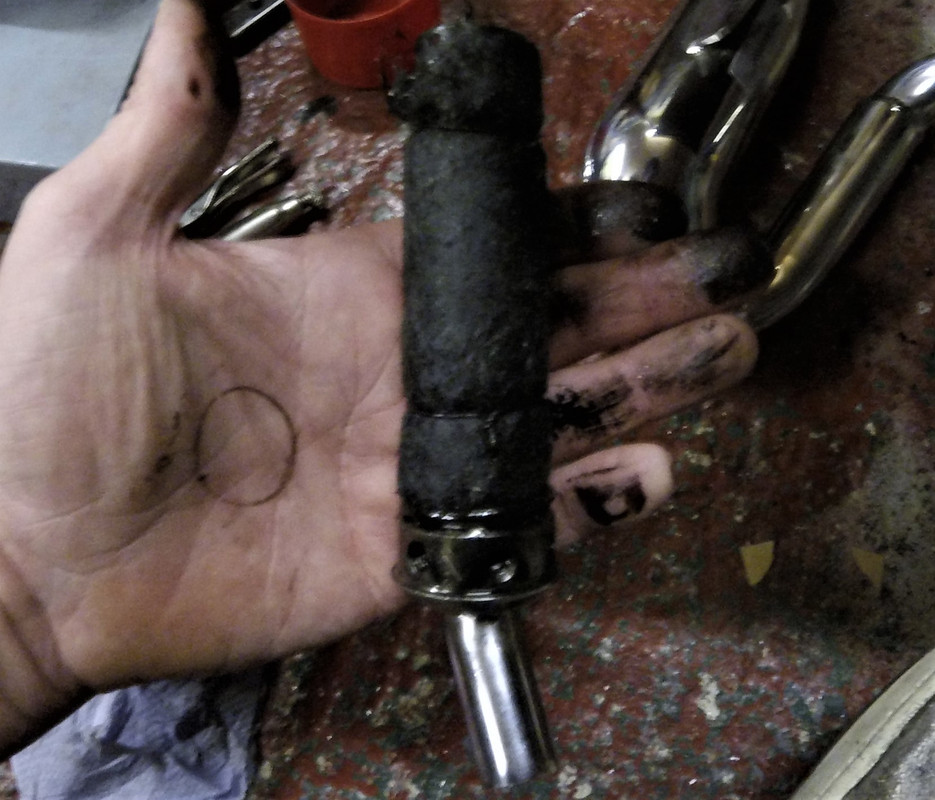

pulled the baffle out to have a check and its soaked in oil,
i was running this on 25/1 for ages though, now on 32/1
the whole pipes very oily inside, gonna flush it out and put some fresh packing on the baffle,
reason i wanted to change the pipe is that i'm fairly sure its holding the 34 reed back a bit ,
