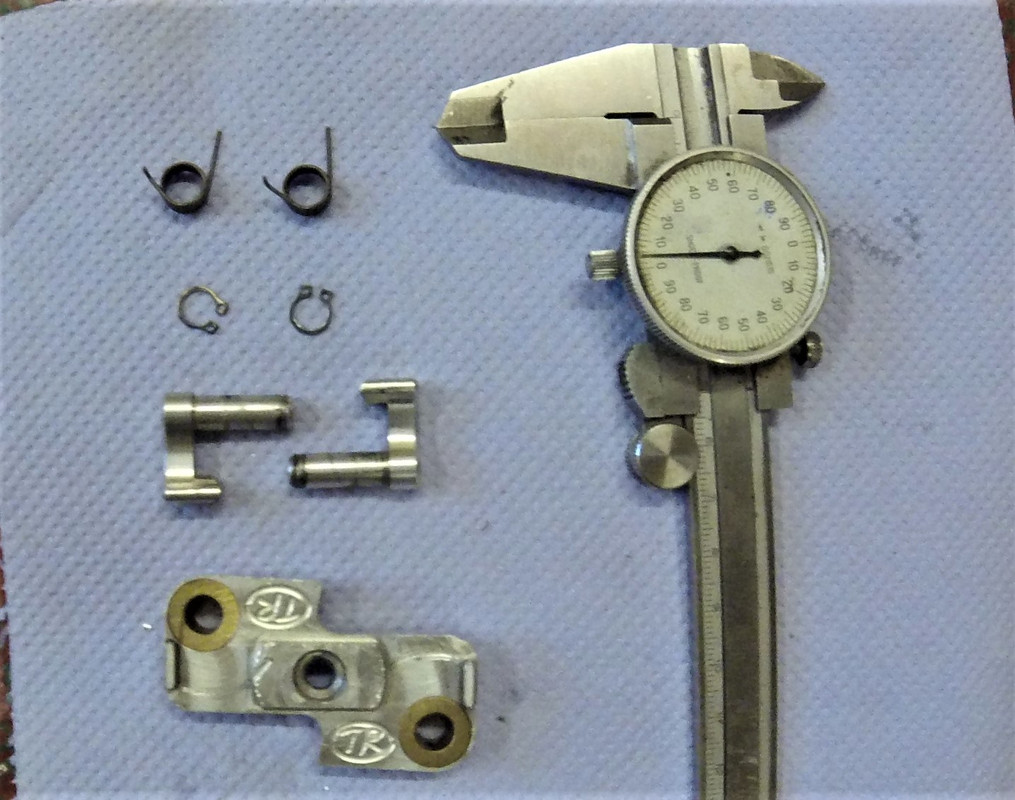

anyways, i pulled the pawl cage apart and had a measure up,
bear in mind theres virtually no wear on the cage/pawls,
but the pawl shafts are 6.2mm and the id of the bushings is 6.6mm,
so 0.4mm of slop with hardly any wear on em, thats been the same the whole way through the turdle starter tbh, lots of slop,
i did look through my boxes of stuff to see if i had some bearings the right size or some bronze to make some better tighter bushings, but no luck,
every other part i've removed all the slop now, and have just ordered the bearing modded pawl cage, so hopefully that will be nice and slop free (y):D,

theres around 1mm of slop vertical kev,
i shimmed it out and the pawls just bound up, i took all the slop out though so the springs didnt have enough wiggle room,
removed the shims and that 1mm vertical is just way too much and the pawls ride over the stop in the centre of the plate,
the turdle pawls have a v notch machined into em on that i take is a wear thing, plus tp stop em binding,
your tolerance is what should be on the turdle ones tbh, you have 0,06mm shaft to hole and the one i have is 0.4mm which is feckin huge really,
should have the bearing modded one on tuesdayy and that should solve the issue,
as long as bearings versus the shaft are the right sizes that is :ROFLMAO:

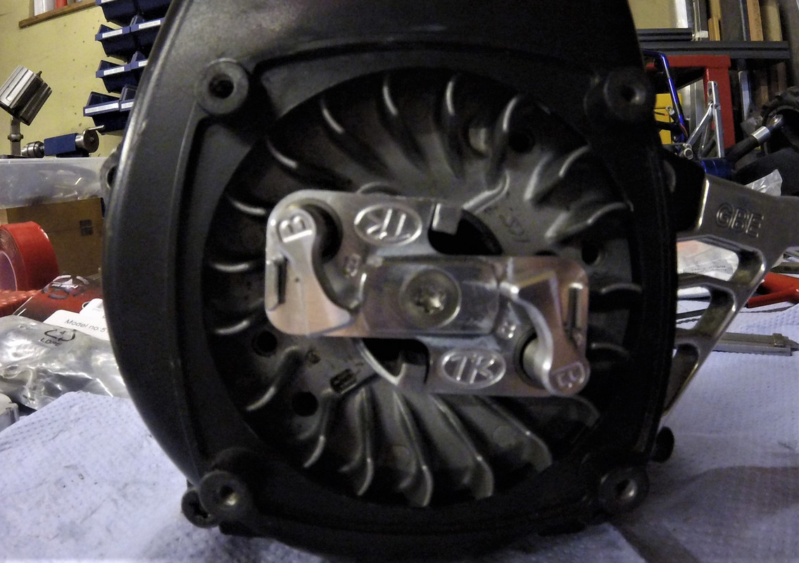

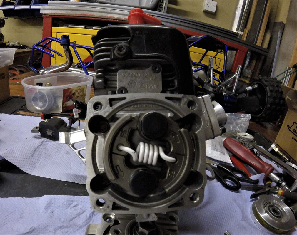

so got the bits needed today (y),
assembled and fitted the turdle pawl plate, so much better is the bearing version , almost zero slop (y),
this is how the bushed version should be ,
then fitted the fs clutch (y),
bit of reference info , if you use a gtb clutch stopper tool, then the stopper don't work with an fs clutch,
the outer edge where the stopper usually grips is a slightly different shape,

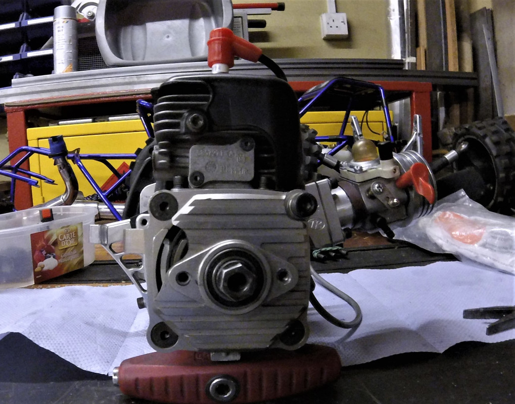

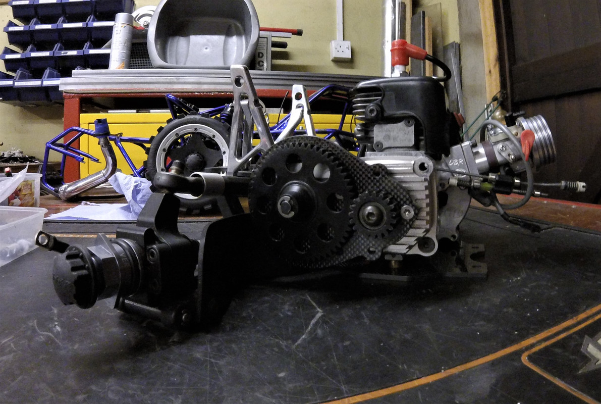

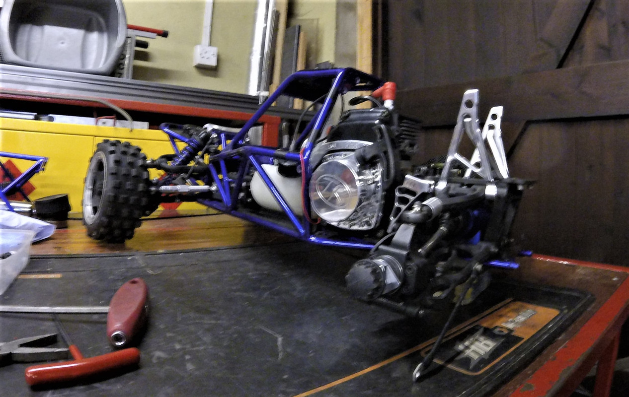

vertigo laust plus carb etc back on ,

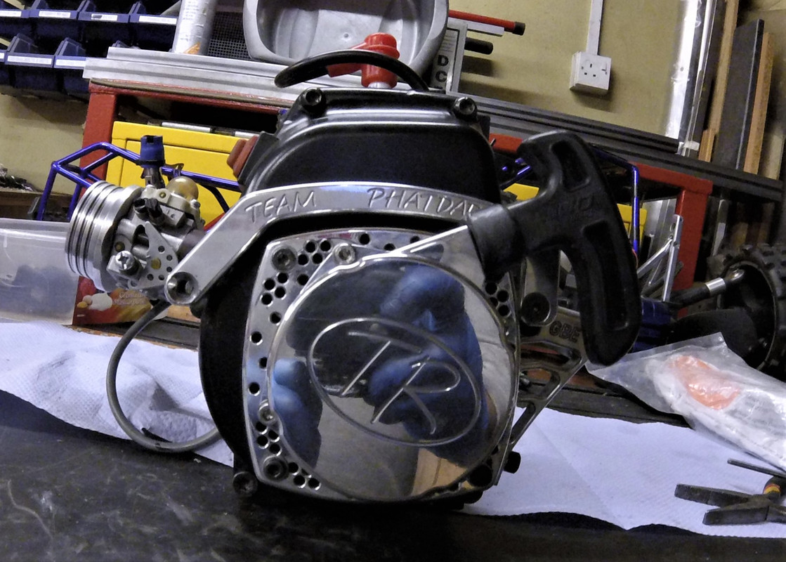

then the turdle starter back together and fitted again,
works much better and smoother now with the billet dog/cog and the bearing pawl plate (y)
