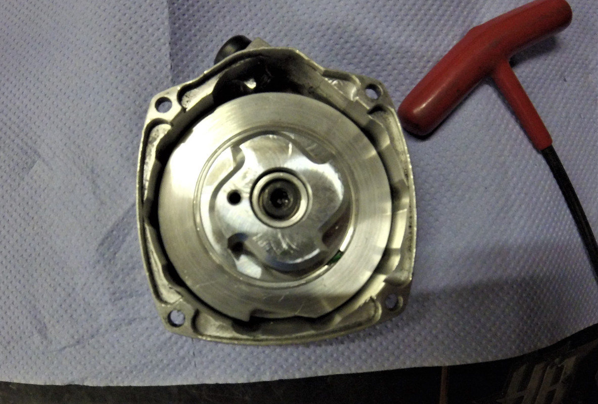

so been messing around with the billet dof/cog for the turdle pull starter,
just getting it to fit spot on with minimal play and smooth etc (y),

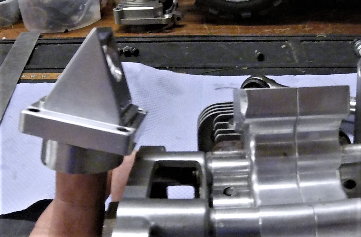

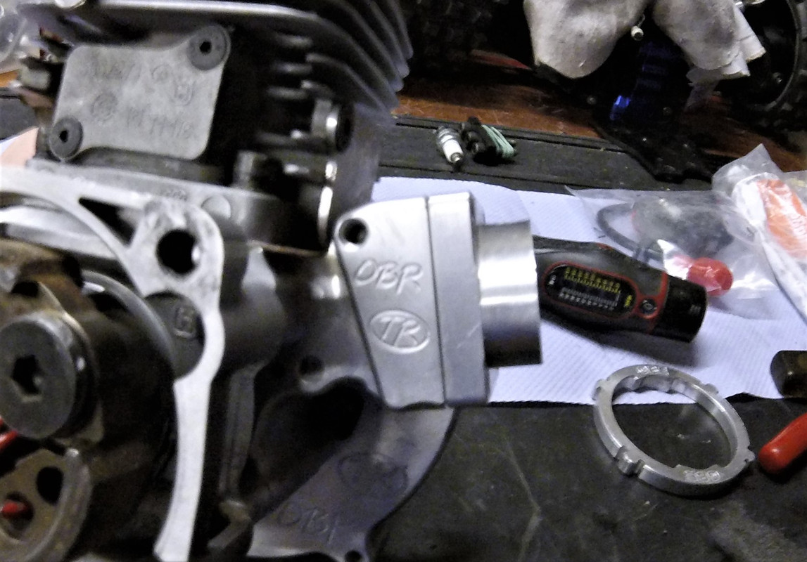

then turned my attention to the reed block,
now this has always been a give it a good shove fit for some reason :D,
then something occurred to me, the reed cases don't have a bolt on the bottom side close to the opening,
so maybe the tight reed block is opening up the case slightly and causing the air leak there,
measured everything up and yep, 0.2mm bigger with the reed block over the size of the inlet,
so 0.1mm off each side of the block itself and it now fits spot on (y),
i forgot to take a pic of the witness marks on the reed block 🤦‍♂️,
but it now slides in with a nice snug fit (y),

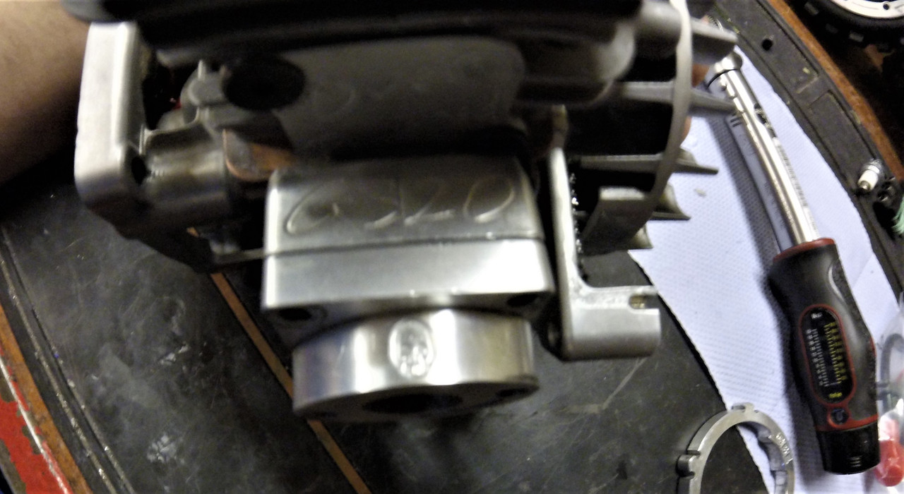

also for anyone with one of the obr reed case engines, theres two skulls engraved on the ree block,
a faint one and a deeper one, the deeper one always goes upwards so the pulse hole/slot is at the bottom,

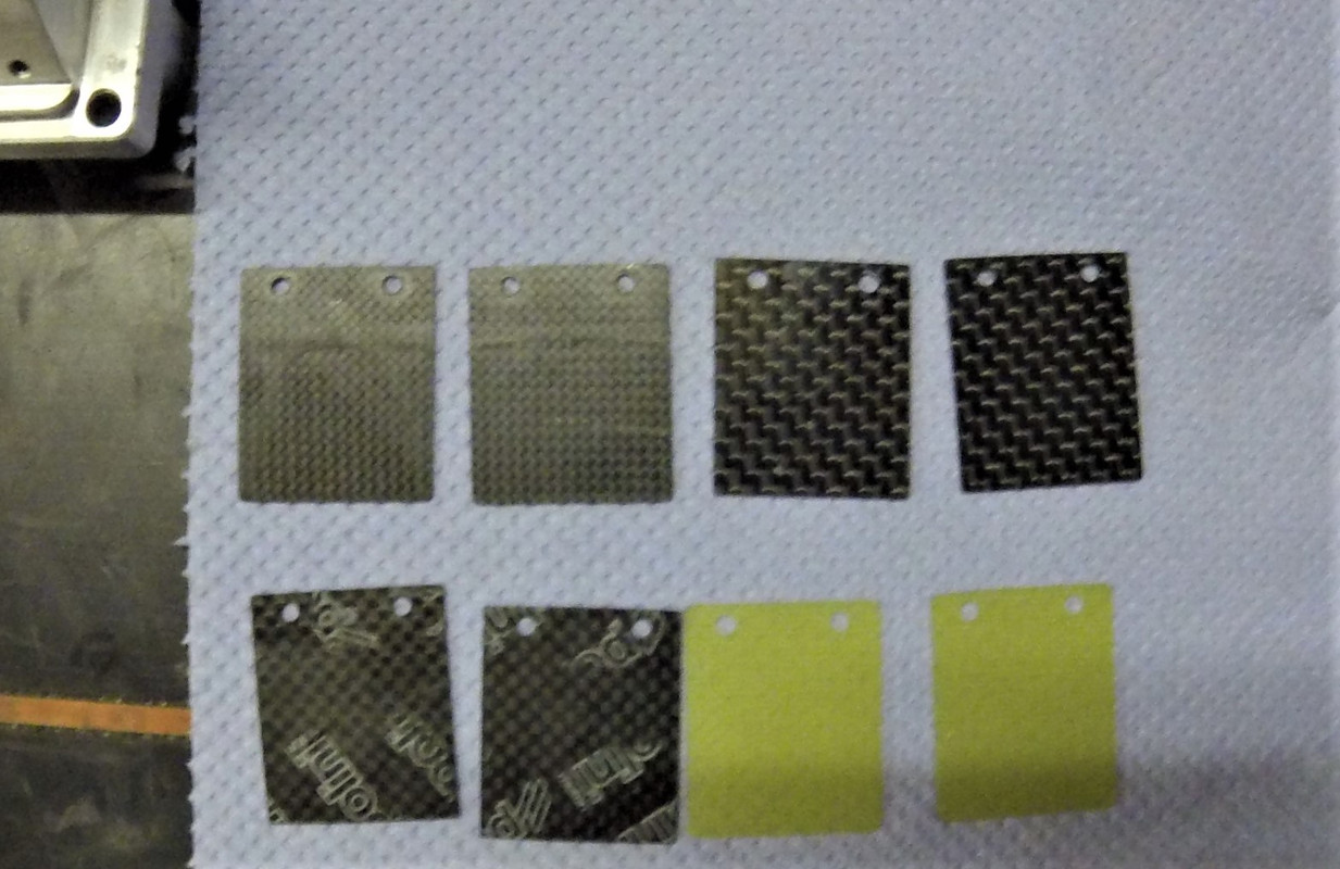

still need to make a gasket , plus also decide which reed petals are getting fitted, carbon or fibre glass,
might fit the fibre ones cos i think there obr ones,
