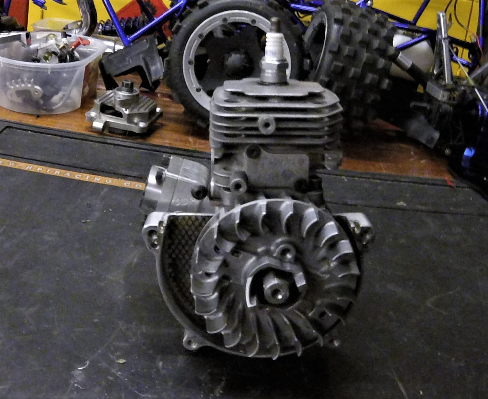

yeh but may as well split the cases and have a proper check of bearings etc, plus make sure the springs are still on the back of the seals ,Can change the seals without splitting the case im sure that's what you'll do
i don't actually have the gear to do a pressur test vac test sean, i know i should have really though,If have it out, just pressure and vac test it. Very simple to do on these then you know your 100% no leaks. And you could have a buggered needle and seat if it's that picky on the adjustment. Can't think of anything else carb related that could be an issue, I'm sure you have the metering lever set right if your not running it out of fuel and idle adjustment is easy.
Yeah that's why I'm saying pressure and vac test. It's not a carb issue. 3 different carbs and the thing still doesn't run right. Either you have the world's worst luck. (And should just post me the hammer before you hurt it ) or you have a oddity in that engine.yeh but may as well split the cases and have a proper check of bearings etc, plus make sure the springs are still on the back of the seals ,
thats as long as the case bolts will come undone ,
new seals are £6.40 for the pair, bearings are £12 for the pair etc,

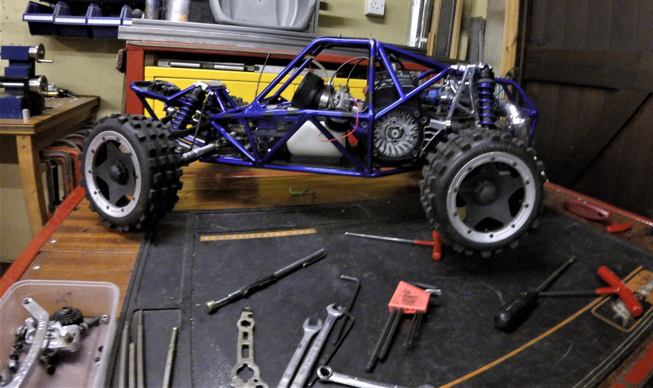

might throw a new ring at it as well, but tbh the engines only got around 4 hours or so on it since last rebuild,
its just really annoying me that its doing what its doing and bogging for what seems like no reason,

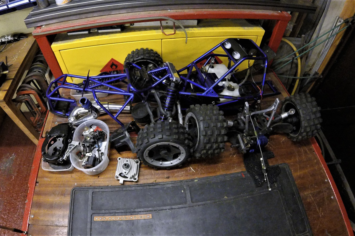

i'd rather have the thing fully to bits and triple check everything one last time if ya get what i mean

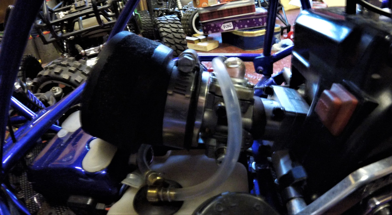

its picky on 3 different carbs though sean, exactly the same with a new 668, an almost new 1107 that i know works well on another engine, and another 1107 that i have had issues with in the past,
idle and low speed is spot on sean, its the transition from low to high needle when it bogs,
new plug was used and it looks super rich after the running yesterday,
i will get to the bottom of whats wrong though , i'm determined to ,
thanks to yerself and dougy mcfresh for answering as well
yeh i'm sure i can rig a pressure test up easy enough with stuff i have here sean ,yeh have compressor and regulator so pressure test easy, vac test a tad more difficult cos i don't have a vac pump,Yeah that's why I'm saying pressure and vac test. It's not a carb issue. 3 different carbs and the thing still doesn't run right. Either you have the world's worst luck. (And should just post me the hammer before you hurt it ) or you have a oddity in that engine.
An if you have an air compressor and a regulator you can bugger a pressure test kit together. Easy.
Vac test is just for the seals pressure will tell you everything else. And really if you take the air filter off your compressor and have a gauge that reads vaccum you'll accomplish about the same thing. Be inventive mate! Always a way to do something with what's in hand.yeh i'm sure i can rig a pressure test up easy enough with stuff i have here sean ,yeh have compressor and regulator so pressure test easy, vac test a tad more difficult cos i don't have a vac pump,
will test cold then warm the head/case up with heat gun cos issues only start as engines gets warmer,
oh, and engine is not over heating, normal running temps when issues start,
lmao sean, don't worry , the hammer is being well cared for ,
its defo an oddity with this engine i'm sure sean,
thanks sean ,Vac test is just for the seals pressure will tell you everything else. And really if you take the air filter off your compressor and have a gauge that reads vaccum you'll accomplish about the same thing. Be inventive mate! Always a way to do something with what's in hand.
thanks for this sean ,Make sure you take the clutch and flywheel off before testing. And don't be afraid to submerge it in water wile under pressure if you can't find a leak. About 15 psi or a smidgen over 1bar. Have seen guys go higher, but no need really imo. It's either gonna leak or not.
Edit, should have said if you can't find the leak and it's not holding pressure.
thanks sean , gonna go and make some covers for inlet/exhaust in a minute,Doesn't matter really, just make sure it's when the transfers are open. That way everything gets pressure. I have a spark plug I pounded the electrode out of and stuck a barb in it. Works ok. For my bigger engines I use the exhaust port.
actually making some proper covers sean, 6mm alloy, blank off for inlet side and air fitting for exhaust side,Some inner tube and use the carb, the exhaust basically same thing with a can muffler.
your carb issues have popped into my head while i been scratching my head with with this ryan ,Lately I've been having to tweak the needle lever a hair to get the needle to come off the seat a little more.I know its not right but I haven't gotten to buying the pressure/vac tester yet but this is just my observation on having now 4 carbs recently do this as they were not tuning well
Pop off is a pressure test. You have a compressor and regulator. Aim for 20psi pop. Around 15 psi reset. It's a wet test so make sure you have fuel in the carb before testing.your carb issues have popped into my head while i been scratching my head with with this ryan ,
same here as well, i need to buy sommat to check pop off etc myself, its something i should have bought years ago tbh
