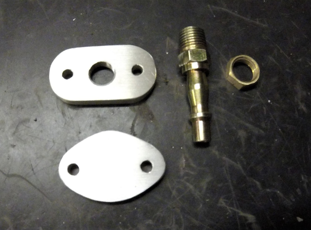

I'm sure it's been covered but how and what do you do with those plates?
gonna pressure test the 34 reed ryan (y) , trying to find out why it runs like a bag o shite when warmed up,

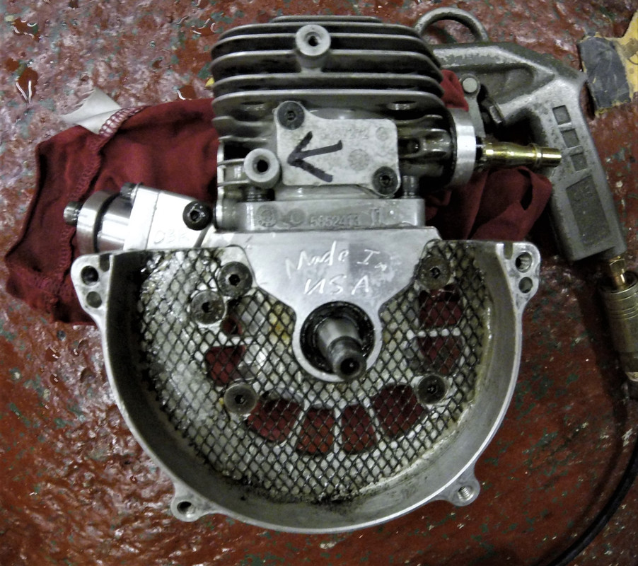

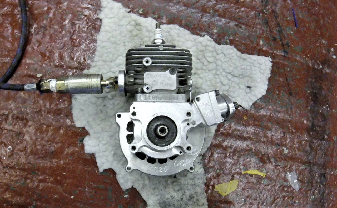

so pressure tested the 34 reed,
straight away theres three significant leaks at roughly 15psi 🤦‍♂️,

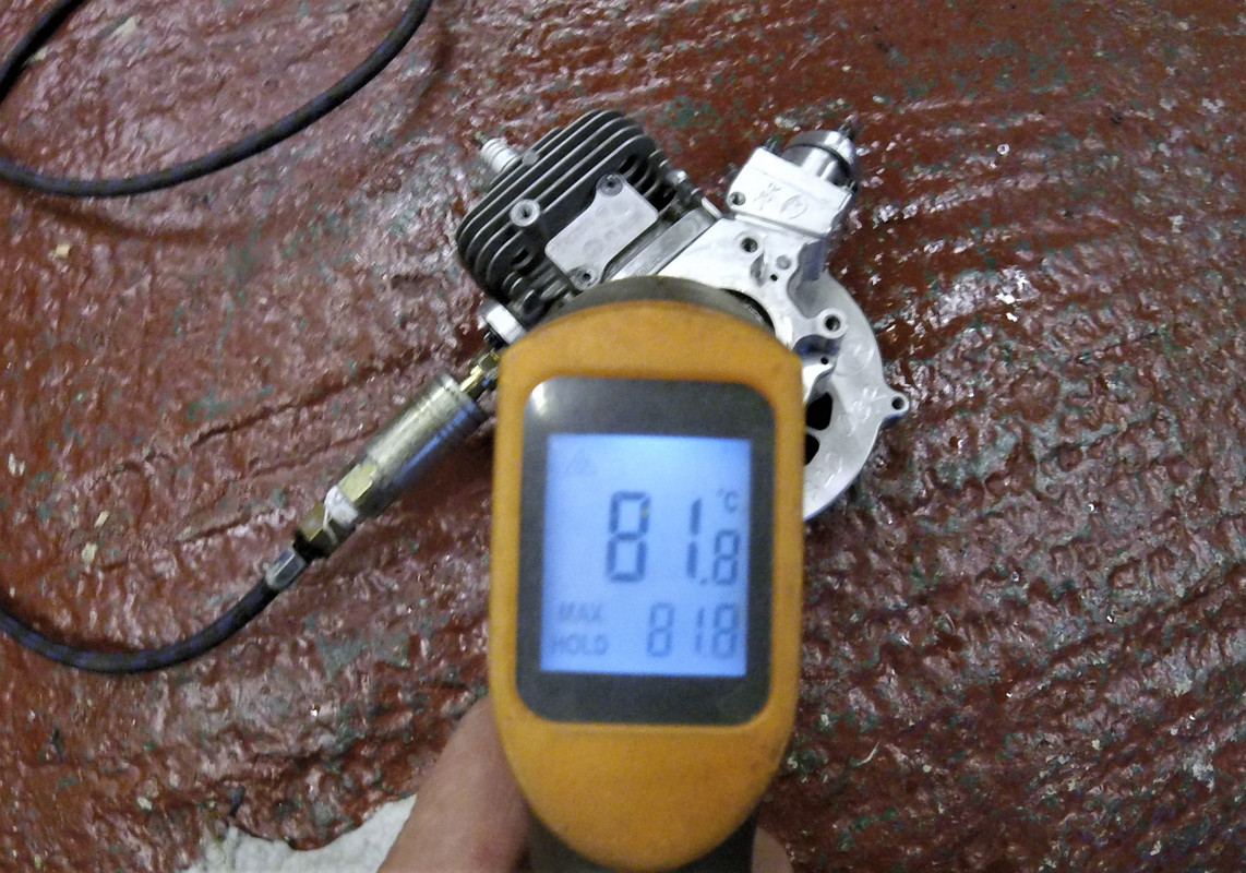

heated the whole engine to around the 80 degrees c mark which is what it basically runs at a t full warm up idle,
well its close anyways :LOL:,
aaaaaand leaks get worse,you could feel the leaks when cold and hear the leaks when hot, then just feel the leaks again when it cooled off,

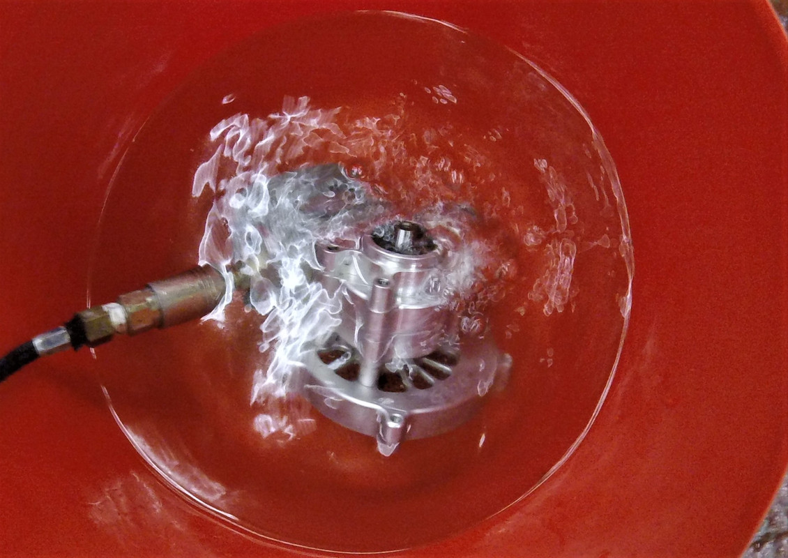

let the engine cool down till it was easy to hold in hand, so above ambient but not hot,
dunked in bucket of hot ish water and yep, bubbles galore,
not just a few bubbles, it was like a jacuzzi in there :ROFLMAO:,

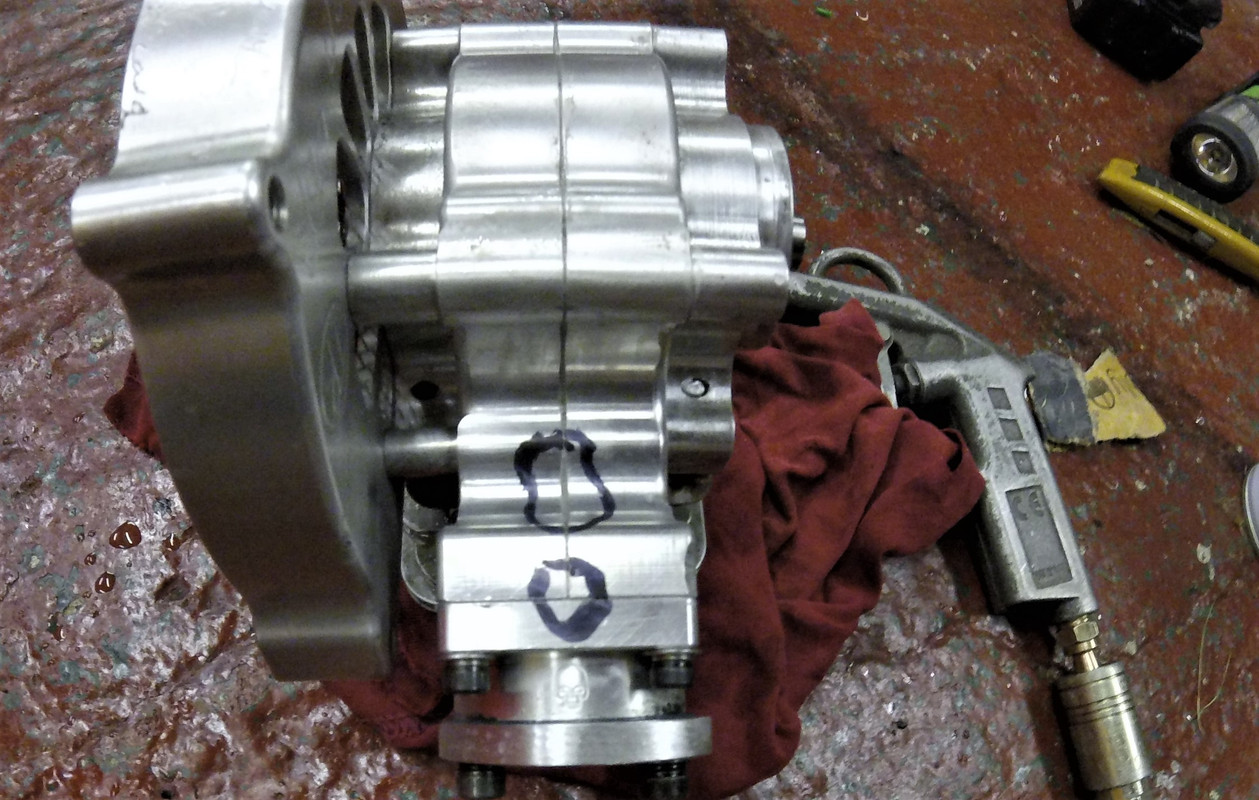

circled are the two main leaks,
and the third is from one of the top end side cover plates,
now the cover plates are my own fault cos there sealed with black rtv, and have since found out that ya shouldnt use rtv to seal the plates cos it doesn't sela properly there,
the case halves are sealed with threebond though as they should have been,

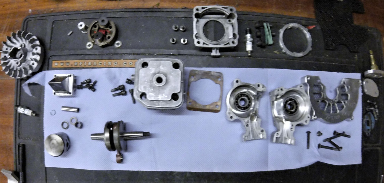

sooo, its apart fully now :ROFLMAO:,
not sure how to tackle this yet,
maybe lightly lap the case halves to see if theres a low spot or sommat,
needs to be done lightly though, pain in the arse that obr don't use a case half gasket on the 34 reed cases,
bearings are spot on super smooth still, seals seem fine as well, but may change em anyways as i have new ones, and there cheap anyways,
the one main issue i do have is the cover plate screws seem to be made of cheese and the heads are turning out of em straight away,
gonna have to heat the scews up a tad and see if that helps, both plates need to come off anyways to be re sealed with threebond,
so hopefully i can get all four screws out of there (y),

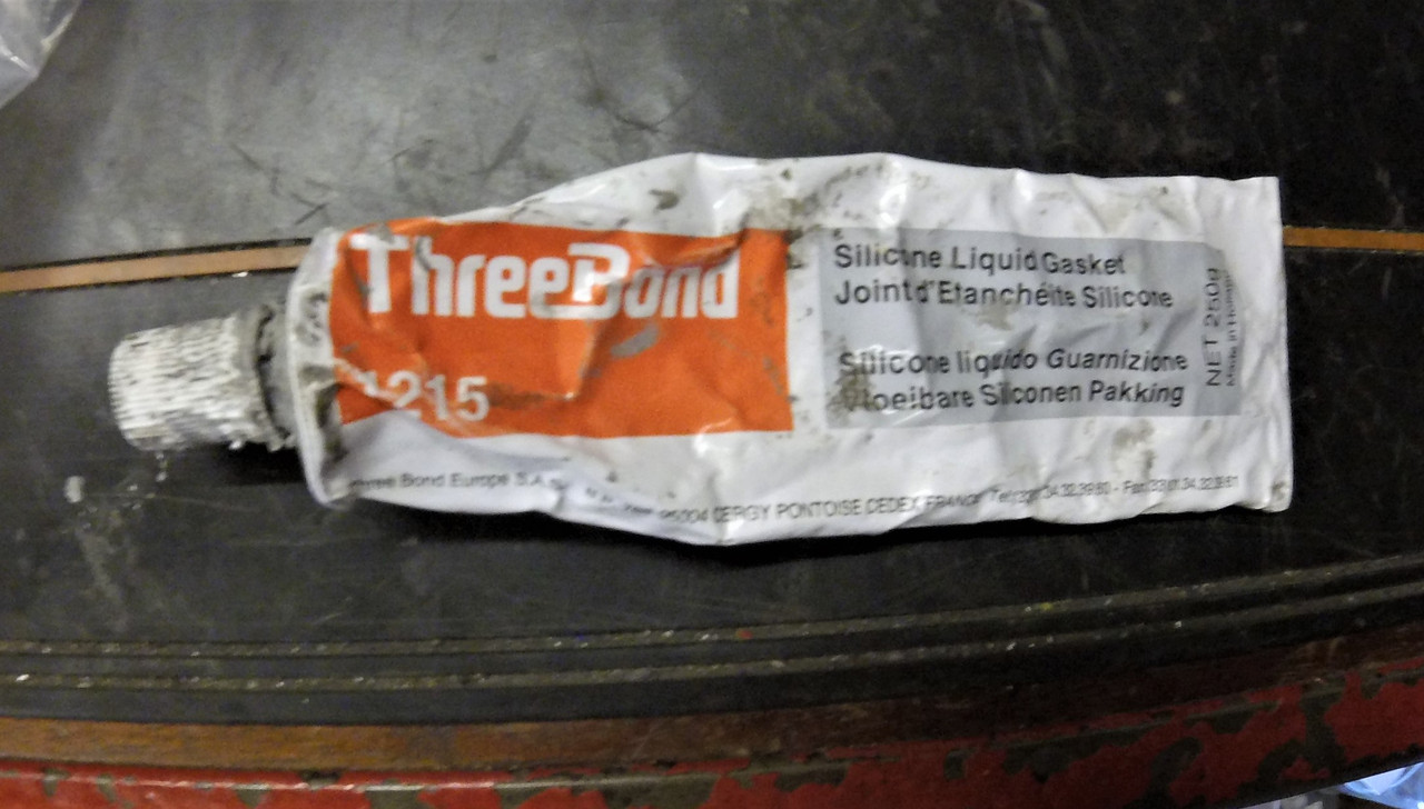

I have been using the 1211 sealer on all my rebuilds works a treat👍🏻
almost the same as what i'm using then doug, i'm using 1215 (y),
and yeh i really should clean the crud off the tube so the cap screws on proper :LOL:,
i do keep it in a plastic bag as well though to stop it going off,

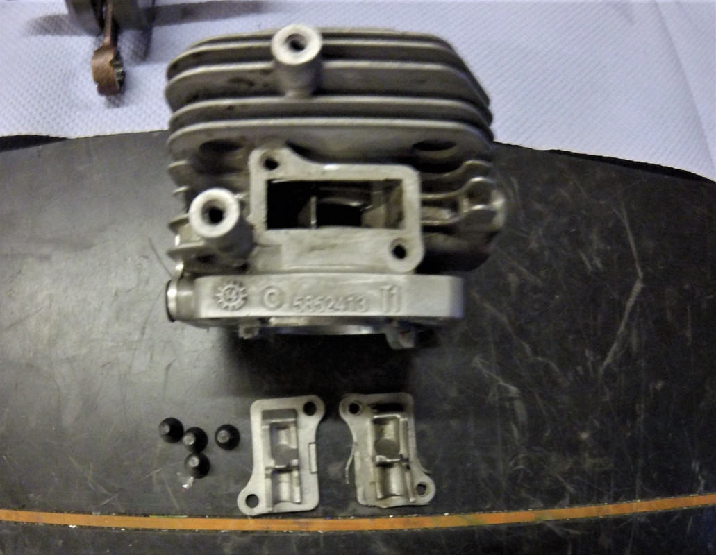

took forever to get the port covers off :ROFLMAO:,
all four screws the heads turned out of em 🤦‍♂️,
so torx bit tapped in and a tad of heat and three of em came out,
the fourth needed the screws hez hole drilling a tad deeper but 0.3mm smaller than the torx bit, then torx bit could be tapped a little deeper and that worked out fine(y),

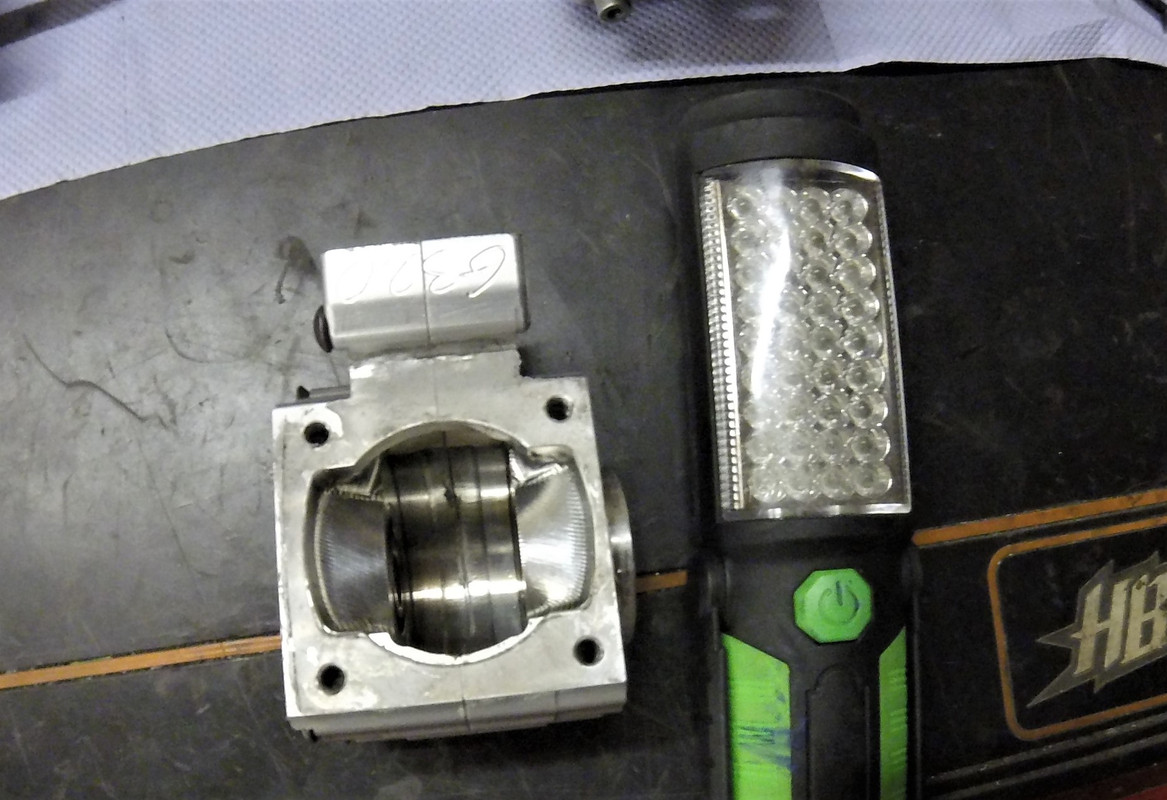

then screwed the case halves together, went out in the dark with a light and could not find any sort of gap anywhere,, around the surfaces,
again, musta been a crappy seal job again by myself, reed block slides in nice and doesn't cause any gaps to open up etc,

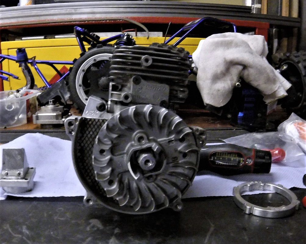

reight then, got the 34 reed back to a long block again (y),
new seals, new bearings, thought screw it and fitted a new ring as well, all sealed up, triple checked etc etc,
