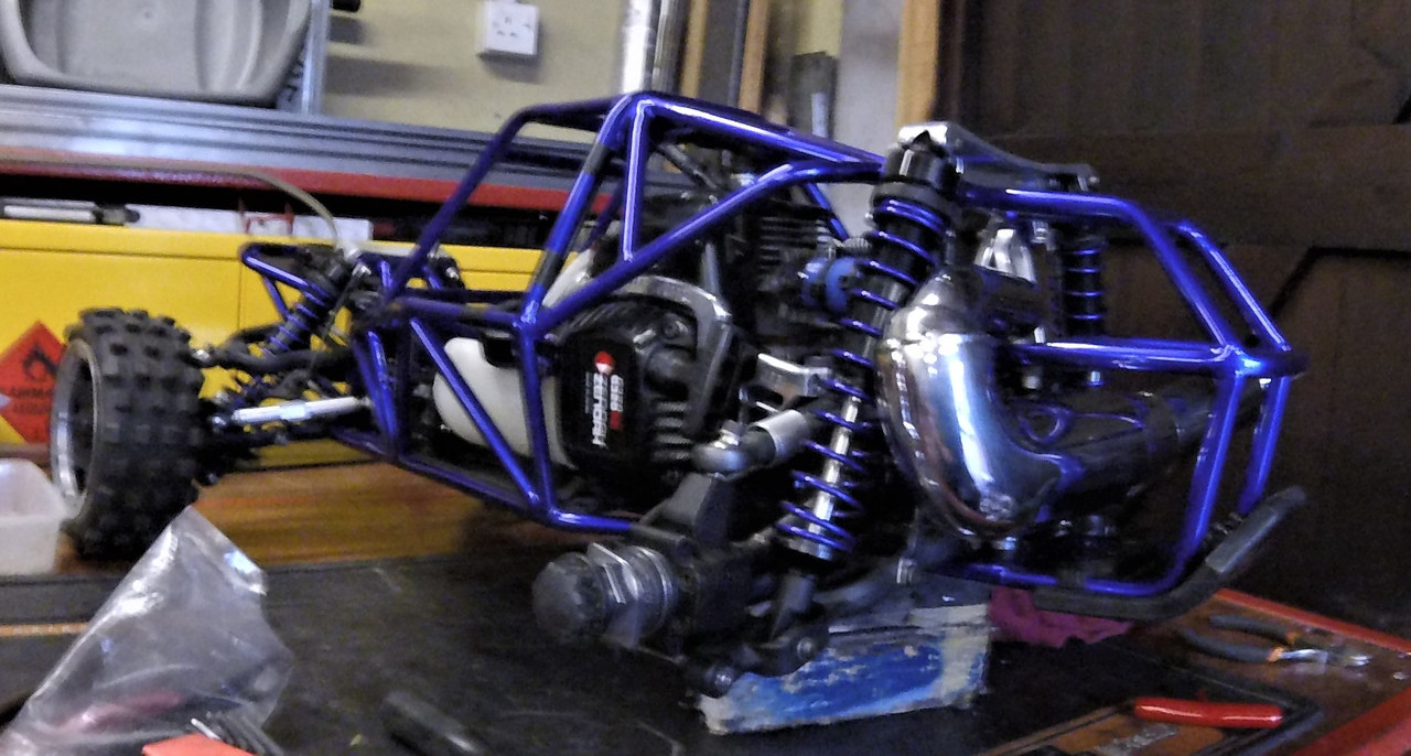

spents shorty roofchopper rail build

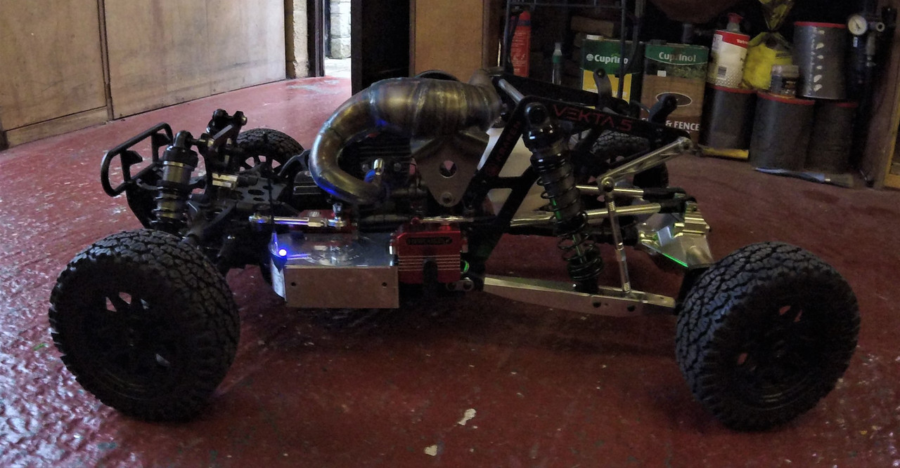

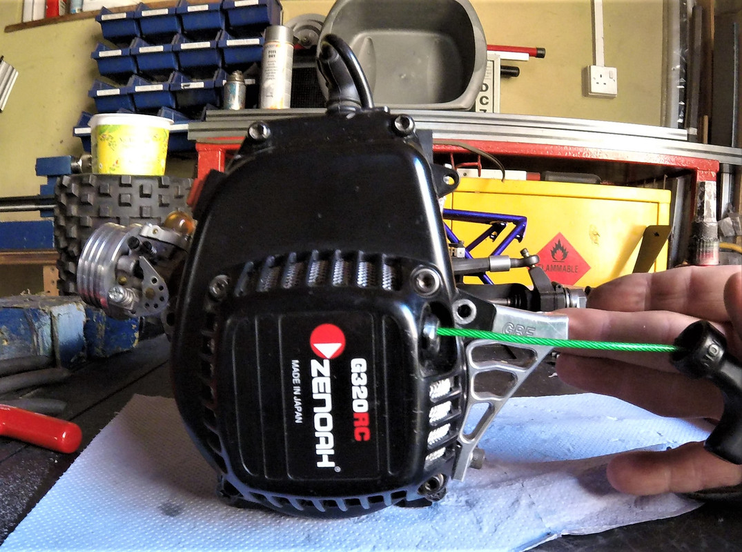

added one of ryans @Rep732 pull start cable kits (y)(y),

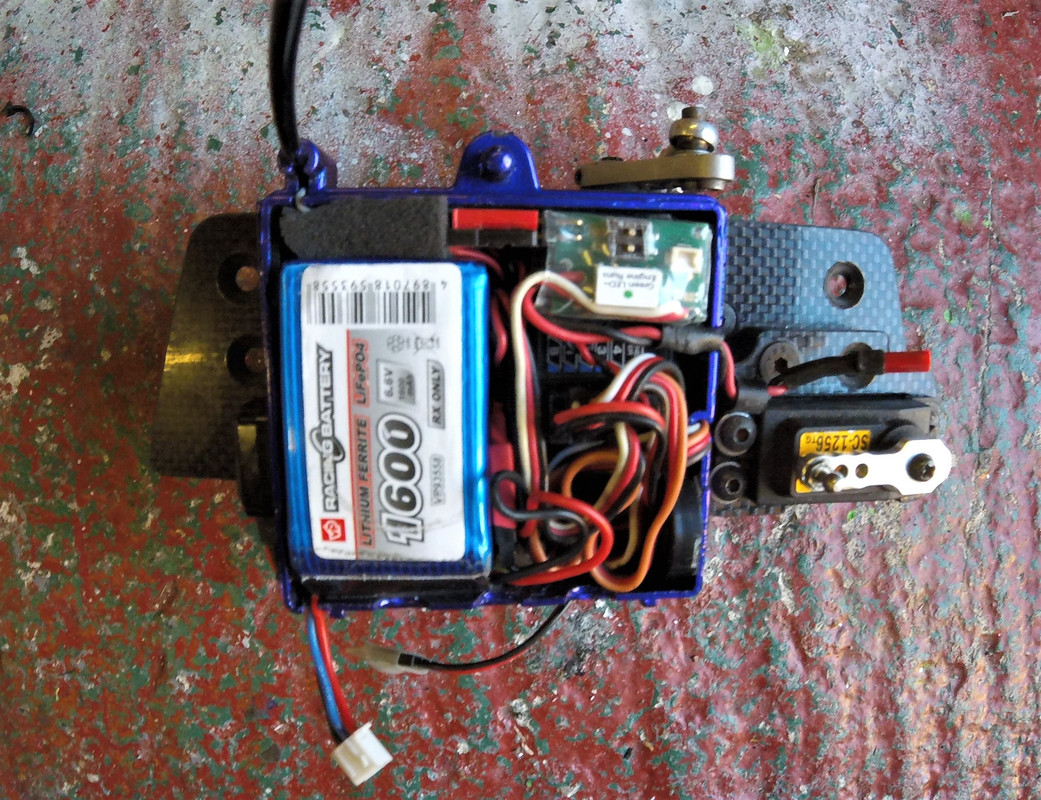

what the inside of a roofchopper shorty battery box looks like, its tight :ROFLMAO:,
1600mah life battery is good for half of a day or so (y),
got this far and called it a day cos went dark outside :LOL:,
i did try the vrc side pipe and its a no no, cage in the way plus its a shorty, it would actually fit length wise but would be tight,
so ddm silenced dom went back on,
well its all back together and connected up apart from the under tray (y),

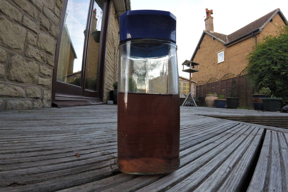

well below is a pic of the petrol/gas mix that came out of the rails tank,
i know for a fact it had rock oil in there, and thats blue, so no idea how it got to be the colour it is now :ROFLMAO:,
its been stood quite a while though,

It's oxidation of the fuel, breakdown of the oil, could be some algae in it too. Pretty normal looking for crusty old 2 stroke gas.
yeh its pretty feckin awful sean :LOL:, in hindsight i shouldnt even have fired the engine up with that fuel in there, shoulda drained it off and used fresh,

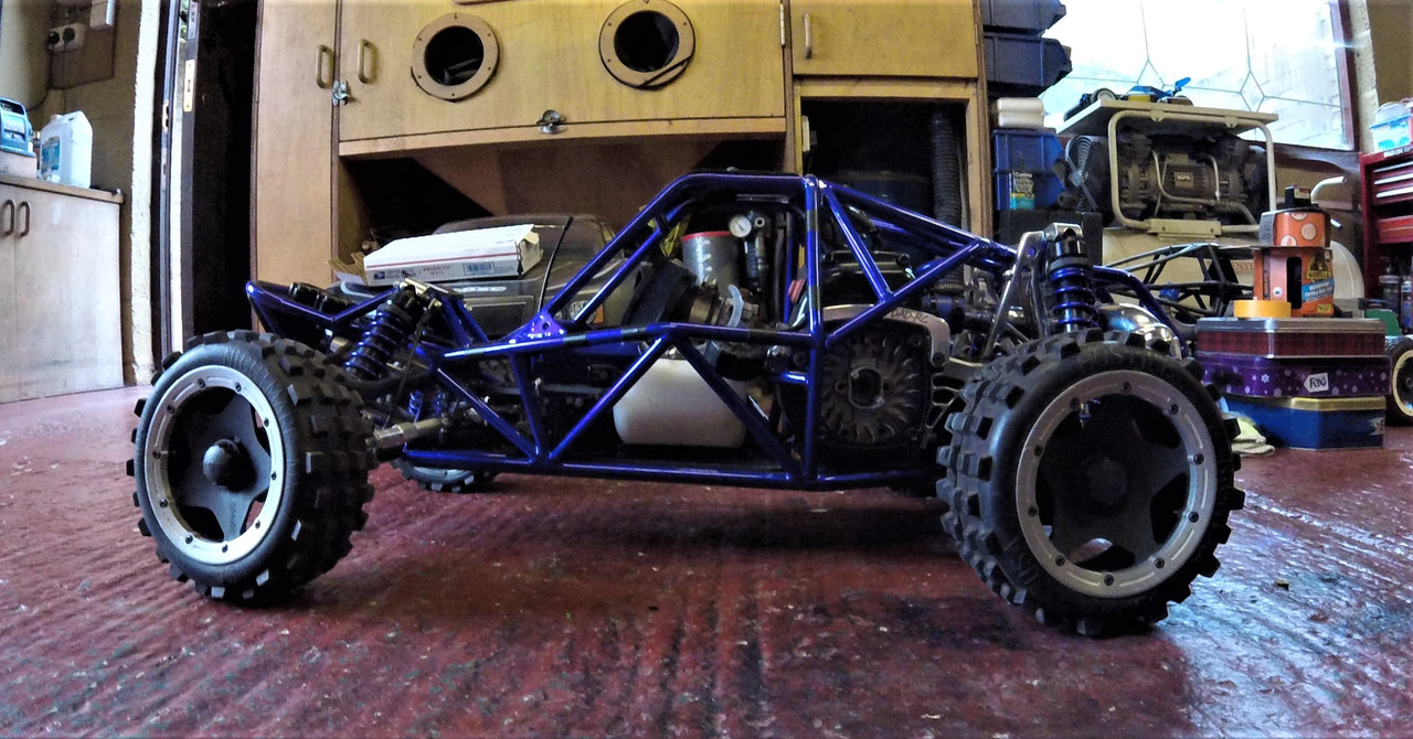

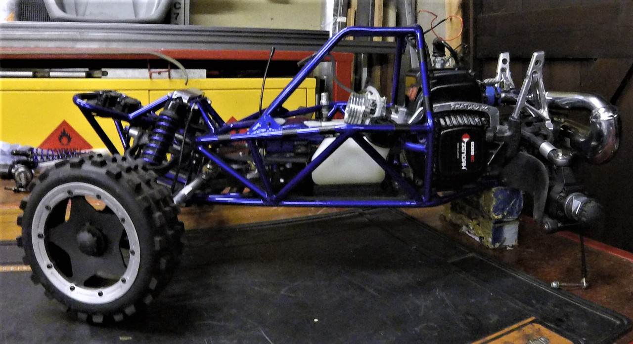

sooooo, refitted the under tray and got it off the bench (y),
some will notice in the pic that theres no pull start on it :ROFLMAO:,
now theres a story here :D,
on the floor, fresh fuel mix, pulled over a few times and it pops,
choke off, fires for a second or two then dies, always does this when its been stripped/flushed and carb reset etc,
up the idle scre 1/2 a turn,
next pull it fires for a second again, getting there (y)

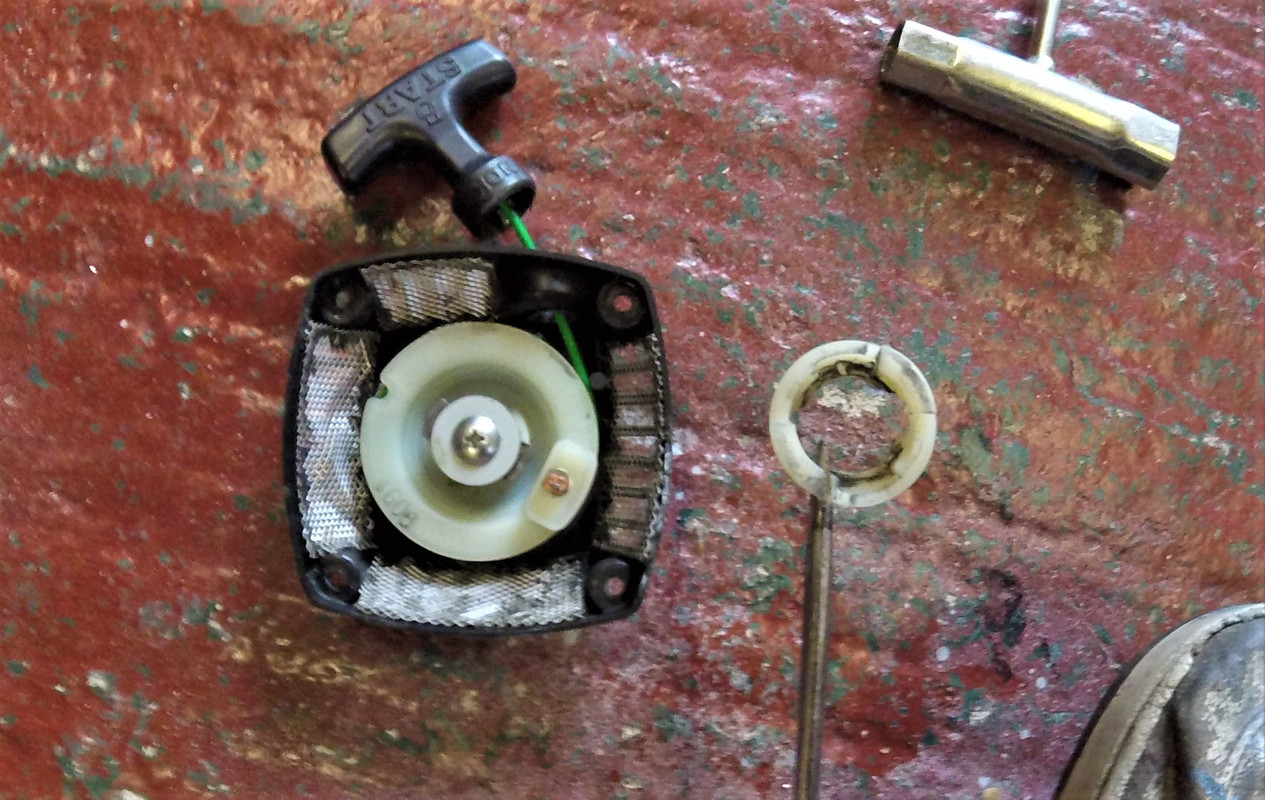

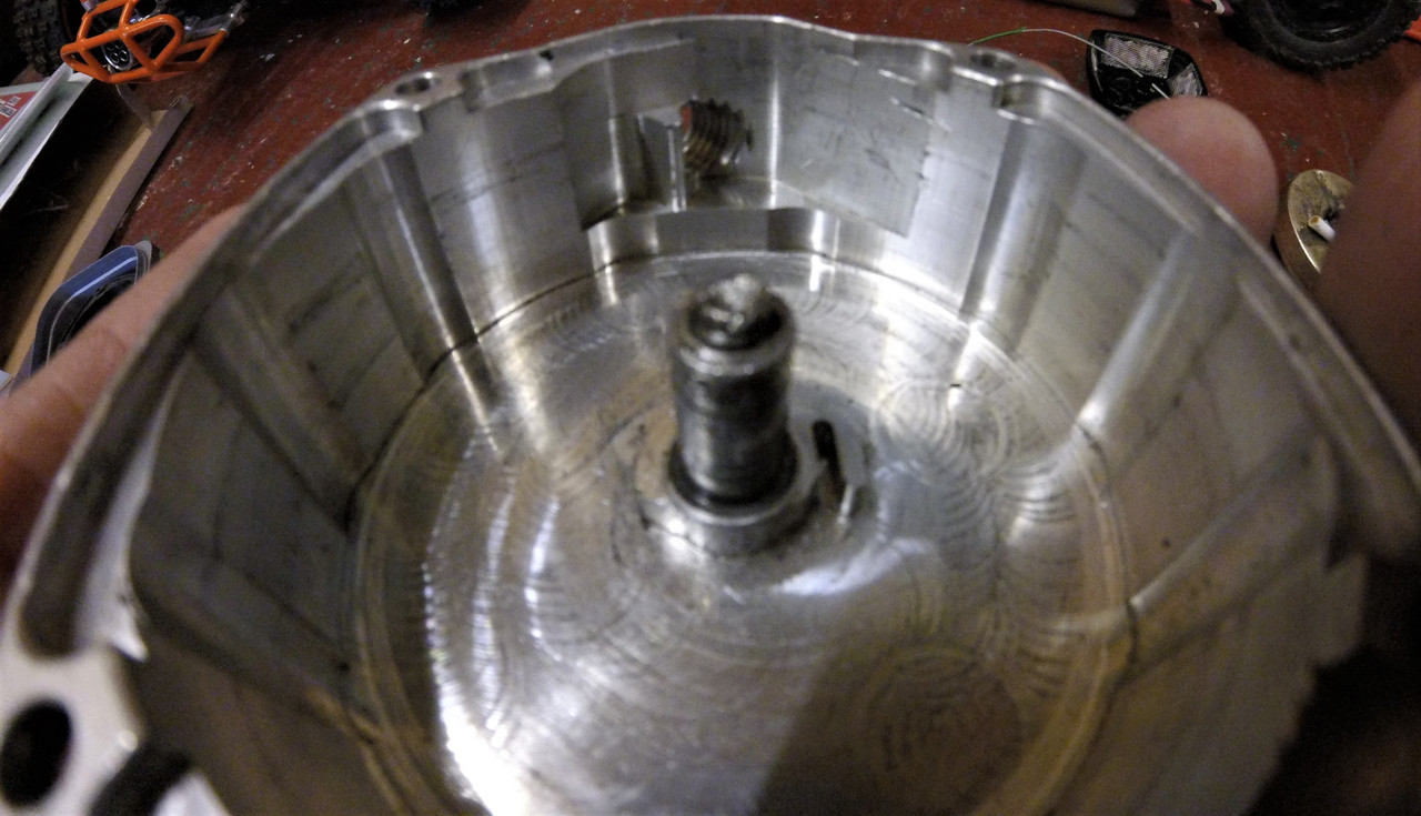

next pull the feckin pull start ate itself :ROFLMAO::ROFLMAO:🤦‍♂️,
think i must have pissed off the pull start gods or sommat lately :LOL:,

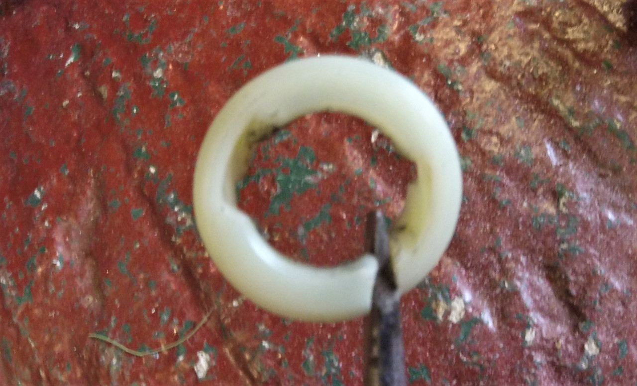

drive dog doodad split wide open and jammed the starter, at the same time the spring jumped so cables now slack ish,
gonna have to have a look through spares boxes and see if i have a decent starter or the parts to fix this one,

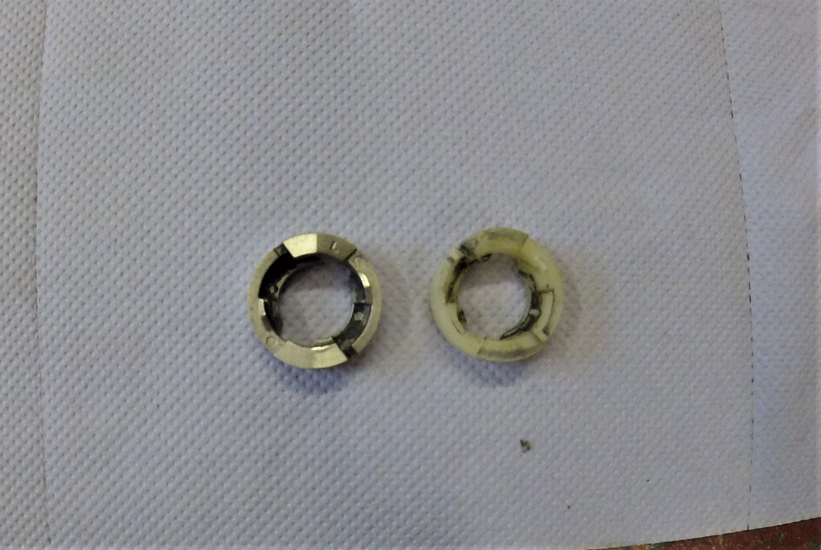

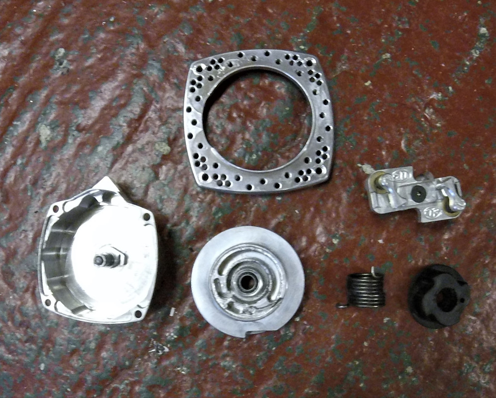

found a metal pawl in spares box (y) , put it all back together and tested before refitting to the engine,
turns out theres sommat else busted cos the main spring wont hold now, it just dislocates when ya pull the cable a few times,
time for a fresh pullstart i reckon (y):D,

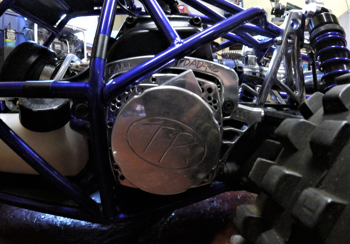

the turtle starter case does look really nice on the rail,
