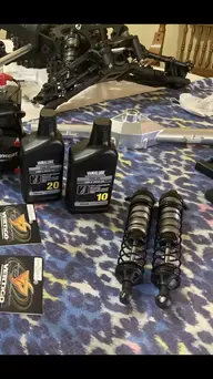

Which shock pistons do you run front and rear? 4 or 8 hole?
