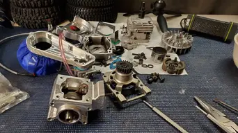

Maybe a reed petal broke off into the motor ?
??I wonder if something broke off inside the aluminum TR air filter assembly? I will have a look tomorrow. I will also check the reed petal Z. I will post my results when I take a look. Thanks for the brainstorming guys??
Wait until I finish uploading the video. I watched it like 100 times while editing and I really can't see what went wrong. Other than the crash where I bent up the wing it was a simple run and the engine sounded good. Other than a slight gurgle at take off from being slight rich. I'll post it here tomorrow too.?
Heat would make a lick of sense tho, as the case was totally blocked by grass, but you would see that (heat marks and such) in the motor like siblues said.
I'm very weary of grass build up? no flow plus @evssv has caught a baja on fire ??and all that grass blocking the air flow
