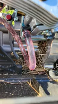

WTF!!! So it was 70 deg yesterday and I went to the park to make a run video. Truck starts out good then BAM, throttle servo horn comes off. No biggie, I pull out a screw from the receiver box switch and and throw it in the horn and I'm at it again. Then BAM, I landed a jump wrong and tumbled and bent up that beautiful aluminum wing. No biggie, just bent it out of the way and I'm back at it. Truck was handling great and the speed was awesome, even tho still a tad rich on the top end because the engine WAS still new. Then I come around a turn and out of nowhere she shuts off. Primer bulb empty, reed case was full of grass, and the pull start was hard as fuk to pull. WTF?? Long story short see below??

damn ??? only thing I can think of is a leaky air filter or something. You find any grass or traces in the motor? Other than the totally fiddlesticked piston and cylinder.

I couldn't find anything damaged in the engine other than the piston and head. Couldn't find any debris in the crankcase?‍♂️
Damn man that sucks.I am new here but I don't think the grass had anything to do with it but I could be wrong.That looks like metal to metal contact damage and the color of the piston looks good so not overheating or lack of oiling.I could be wrong though.How is the ring?
Definitely looks like metal contact. Ring was stuck in the groove where the battle scar was.

We're Gunna need a Sean analysis on this one I think . Siblues makes a good point, doesn't really look like the grass is what did that to the piston. Maybe the carb got choked out and it got super lean ? Although I think you would notice this. What's the plane going forward mate?
Test for air leaks on the case, carb, reed, port covers, and everything else. Maybe it was sucking air somewhere else ?

Case not full of gas. I have to figure out what the fuk is going on. Maybe I'm doing something wrong with the mix?? I mix 1 gallon to the 28:1 mark, then shake up pretty good.
How are the port covers are they sealed up nicely and have you taken a look at the inside of the covers yet?
I checked them and they appear to be sealed and walls intact

Have you checked all bearings ?? I’ve seen similar damage when a small bb from inside a bearing brakes loose inside
I have checked the rod and crank needle bearings and they are there. I haven't taken the crankcase apart to check the crank bearings?

I don't believe it was a oiling or a fuel issue in my opinion and that eliminates heat most likely considering nothing looks like it shows heat or overheating issues.That leaves assuming it was a leak that it let something in.The leak would have to be significant.I am sking could the carb filter let something big enough in to cause that damage and that's assuming it is a foreign object that caused it.Rod movemnet on the crank can cause similar damage but it would most likely be on opposite sides of the cylinder wall.
