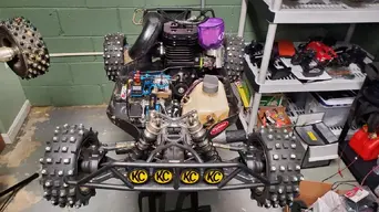

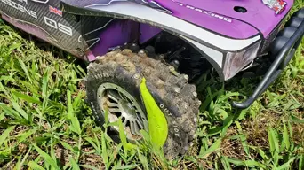

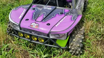

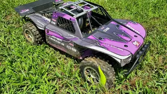

Crucial 5ive-T
Pre supreme. Just a 65cc Vekta. I emailed John a while back about getting the supreme top end and crank for it but he never got back to me.
So I was just thinking about this post and thought about something... Is this the engine you're talking about?
Because I know in the description it doesn't say supreme, but it is the supreme.
Nah I wish. Mine was pre supreme buddy? look at the case and head on that engine and look at mine.
Power compared to your 65?
Kind of hard to compare cause the 5ive is probably 10lbs lighter. I'll tell you the 5ive is funner to drive. I'll get a better idea when I get the vekta back out after repairing the decomp valve and clutch. They were two repairs that I know was killing performance.
Hey crucial can I get a whole mod list in u 5t ? Looks pretty basic ? also what diff oil are u running (front , center, rear) ?
ALX super 50 w 70mm clutch, 27T pinny
Walbro wj71 carb
Twin Air Air filter w Outerwears
ALX 5ive air intake
pro throttle linkage
trailtech tach
BRP big bore unsilenced pipe
Modified RC center diff mount
RCR brakes
Hitec 845 steering servo
Savox 0235 th servo
Killer RC 7200mah battery
Front, rear, upper HR aluminum brace
Stock front and rear shocks w TLR caps 45wt fluid
DDM HD front(14.5#) and rear(11#) springs
KND front and rear shock towers(soon to be replaced)
Losi push-pull bellcrank
TLR gas tank and fittings
Stock center driveshafts and axles
No name throttle brace
1/2" wider aluminum hub axle extender
Uber RC steering servo brace
Stock f/r camber links(soon to be replaced)
Stock steering turnbuckles
Aluminum HR A,B,C,and D blocks
FID racing throttle horn w ball bearings
Rcmax center diff cup with Team Chase damper
Blackbone 50T spur
Stock f/r diffs with 500k fluid
30N cage and panels
Joker Design body wrap
DDM aluminum wheels with Rovan 195x80 tires?
FID racing rear mud guards
ALX steel roof riser
Chunky clunk tank pickup
Snappy RC tank vent
Killer RC super bee killswitch
stock f/r swaybar
Losi aluminum rear hubs
Futaba 4pm transmitter
