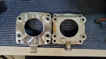

TR billet baja HD clutch housing.
Baja on left. Losi on right.

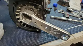

Barty flywheel wrench

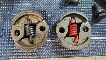

New clutch shoes with 8000k spring. Old ones look good still, but might as well swap em while its out.

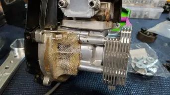

No venting for the bell holder.
Gear plate is super thin.

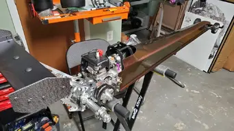

New small block Barty torpedo pipe

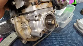

Back at it again. Strip down was fun but time to start building her back up.
Rcmax bell carrier

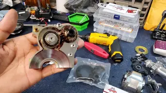

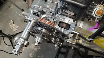

Trans opened up and plenty of lube.

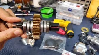

Stock gears removed and Blackbone gears and 2speed layshaft installed and greased.

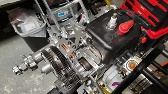

Tranny installed on chassis.

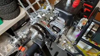

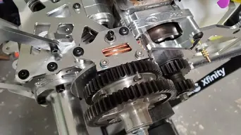

Damn rcmax is thicker than the stock bell carrier so time for some mods.
I had to move the left brace about 12mm to allow it to mount to the carrier. PVC spacers for now but my buddy @Haric is gonna make me some aluminum ones??
Now time for the tranny plate and brake plate. You can also see the RCR pads and rotors.
Looks good on there.

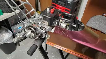

Stock rear hubs and tires wouldn't fit because of the 2speed. So guess I need some BRPs and adapters.

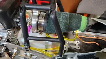

DT1 filter fitted.

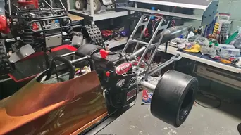

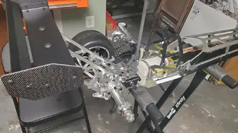

Update time. These are all mockup pics for now cause I've ordered some Bonehead parts for her so ill have to tear her down to install when they come in. When I tear her all the way down I may be tempted to build her back up w the 71?
Wheelie bar

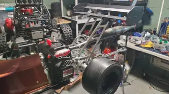

7x4 BRPs I waited 2mos for don't fit ??‍♂️ Hotting the 2speed layshaft. Why do some have deeper offsets than others?
Put my baja 6x3 on for now while my extended hubs are ordered.

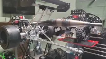

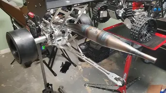

Barty pipe wheelie bar installed

These are cool but they get real expensive real quick. I bet that thing is almost unique at this point.
You can run it in the stock form but the tires are not the best. Also didn't believe it didn't come with a wheelie bar. Also any baja pipe will fit but the torpedo pipe looks good and I feel the balance would be better.
