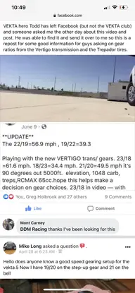

@PortCityRC someone did a test on the vertigo gears w/ a 65cc ‘cept the 24/17.

Thanks brother! Good info!🤘🔥🤘.I bet I had lots of spin with factory tires. I'll get her on pavement..she should be well into the high 60s maybe low 70 according to this. These spikes are 195mm not much taller than treps. 5mm
That's actually impressive speeds for being gas and their size. Do the baja gearing setups have just about endless gearing? One dudes pulling 93mph outta 65
