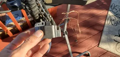

@Clubin I agree and im wondering if it's the cause to it. I need to take it and hook it up to the shop vac and dump a poop ton of dust on it and see. If I cover the ends and It doesn't strain the vacuum I'd say it was the culprit
Looks minty fresh! 😎 Screw that TR intake and eliminate it as a variable!
Me and buddy I run with run in some pretty dusty stuff. It does make me nervous, especially seeing what you’ve went through but haven’t had any issues. 3 outta our 4 rigs are just running stock air filters. Both of us are using Maxima oil on our filters.
I’m going to do something different that tr intake makes me nervous. I looked at your pics. That’s where the dust was coming in. That’s a design flaw with the product.

Thanks guys, I see the same flaw tho in the rovan intake and that it's 2 piece with a o-ring. So I took some extra time this go around and I used the same case sealant that's used for the transfer port covers. I put a small bead around the entire cover along with leaving the o-ring there to make sure It cannot open up at any point. Looking back I did see I pinched the o-ring in 2 spots that were about 5mm long so I could have sucked it in there. Also the conditions I ran in where to the point that the rigs were completely lost in the dust storm. I'm ok with grass running this as the x-maxx has now taken the spot for super dusty conditions and beach runs now. Here's it is pretty much ready, I just need to put the center diff brace on and install the chassis side guards and im done20220911_205248.webp
Thanks guys, I see the same flaw tho in the rovan intake and that it's 2 piece with a o-ring. So I took some extra time this go around and I used the same case sealant that's used for the transfer port covers. I put a small bead around the entire cover along with leaving the o-ring there to make sure It cannot open up at any point. Looking back I did see I pinched the o-ring in 2 spots that were about 5mm long so I could have sucked it in there. Also the conditions I ran in where to the point that the rigs were completely lost in the dust storm. I'm ok with grass running this as the x-maxx has now taken the spot for super dusty conditions and beach runs now. Here's it is pretty much ready, I just need to put the center diff brace on and install the chassis side guards and im doneView attachment 83563

Thanks John, I take extra care to make sure that pipe keeps rust off it as well. As for the cap I just used the o-ring it came with, I did try to put the guts of the old cap in but it would not fit right.
