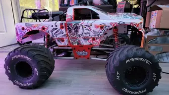

Braap’s raminator build
I'm on my 4th differential, now do I have to drill threw it. What size screw is that. Also do I have to dremmel that Red part of the differential to make clearance for the lock nut.
Remove all four stock screws, drill out the holes using an 11/64 bit. Then use a dremel and carefully and slowly grind down some of the red housing of the diff just til the nylon lock nut can sit there. I apologize as I don't remember what size screws I used and I am at work for next 10 hours. I can try to check when home tonight. The key is to use a screw that fits snug into holes with no slop and just extends through enough to completely come through the nylon lock nut but not stick out super far. This is a fix a lot of us are doing and seems to be a solid repair and solution! 🏁🏁
Remove all four stock screws, drill out the holes using an 11/16 bit. Then use a dremel and carefully and slowly grind down some of the red housing of the diff just til the nylon lock nut can sit there. I apologize as I don't remember what size screws I used and I am at work for next 10 hours. I can try to check when home tonight. The key is to use a screw that fits snug into holes with no slop and just extends through enough to completely come through the nylon lock nut but not stick out super far. This is a fix a lot of us are doing and seems to be a solid repair and solution! 🏁🏁
Thanks alot, cause I was ready to throw this truck in the trash, cause it ain't nothing but problem after problem and sleepless nights looking for a fix. $3,000 for a headache and stress.

The diff bolts back out inside causing major destruction to everything. It's just a simple fix to rid the problem
I was really hoping in all that he purchased , there wasn't a worthless nudge bar in there , don't buy that piece of crap , looks great , but if the wind blows in northerneasterly , you will need a new one , also in a different rant I saw you guys having issues with the bolts on the diffs ? Evidently I've been lucky I've had no diff issues yet , is everybody trying heat before turning these bolts ! Or is there a different problem going on there , I know I'll be doing them , so very curious as to what's going on
2 of mine were snapped and broken just barely hanging in the diff without even touching with a tool. Another run or two, would have backed out and been a bad expensive day. Not gonna run my truck again until I open and mod the front diff. I would get ahead of it and do yours Relic.
