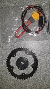

I posted a few times about those now, won't be using them anymore, switch to these man. Rob showed me these, just pull them to kill the engine and install for power View attachment 79249
I guess i didnt do enough research on the killer rc switches becuase i really thought they were the way to go. Can you tell me where/ what that is you are using there?
