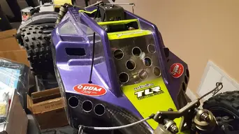

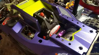

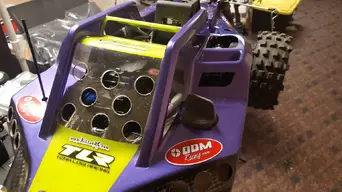

I don't have a problem with the sto k air box??what exhaust are you running? have you vented your chassis side pods at all?
are you still running the 34cc with victory pipe?
that 34cc will create a lot of heat
bore some 1/2 holes in the body in front of the air filter. a tgn style air filter will also help as it can suck air from the front of the carb through the holes in the body, where as the stock air filter supplied in the kit is not great imo as it only draws air in from either side of a hot engine
Its plenty of ventilation there crucial ???Yup 34cc with VRC pipe. No I haven't vented the side guards.? But I have a ton of openings in the body and I header wrapped the pipe.
View attachment 53024View attachment 53025View attachment 53026View attachment 53027View attachment 53028View attachment 53029
Yeah I have read your thread and respect your opinion for sure, but don't think the guard venting should be needed with all the body holes and header wrap on the pipe. I will do it at last resort if needed tho.I understand you have vented the body but I really would suggest venting the side pods.
